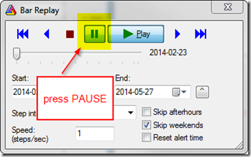

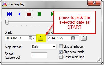

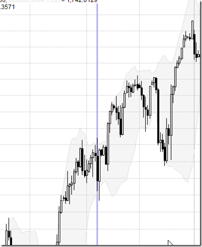

AmiBroker 回覆了
- mark the START BAR on the chart with the vertical selector:
- press PICK button for start date:
- repeat the process for END DATE too
- press PAUSE
Then – start the replay and check if you’re still getting crash.
雖然很感謝回覆
但是有點麻煩些 XD
等假日沒交易時再來測試看看這個方法囉
我還有建議可否簡單一點的方式
skyler + 2 好文章,我推薦
