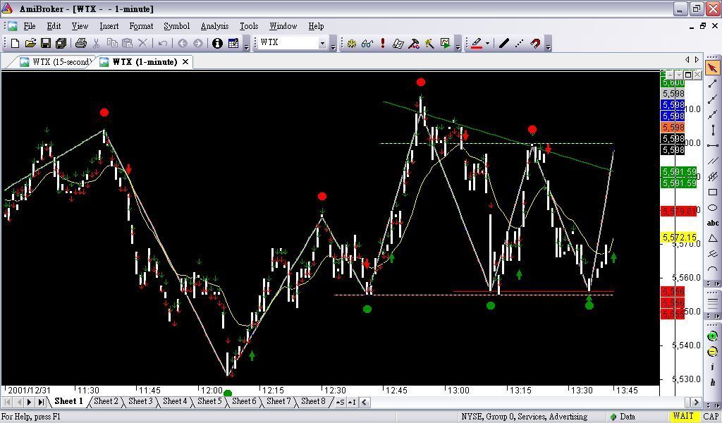

查看: 4880|回復: 2
Advanced Support Resistamce Buy@sell for Amibroker
發表於 10-6-11 16:27 | 顯示全部樓層 |閱讀模式
  1. _SECTION_BEGIN("advancesuppresibuysell");
  2. ///////////////////////////////////////////////////////////////////////////////////////////
  3. SetChartOptions(0,chartShowArrows|chartShowDates);
  4. _N(Title = StrFormat("{{NAME}} - {{INTERVAL}} {{DATE}} ,{{VALUES}}", O, H, L, C, SelectedValue( ROC( C, 1 ) ) ));
  5. Plot(C, "", IIf(O>=C, colorOrange, colorGreen),styleCandle);
  6. SetChartBkGradientFill( ParamColor("Inner panel upper",colorBlack),ParamColor("Inner panel lower",colorBlack));
  7. _N(Title = EncodeColor(colorWhite)+StrFormat(" {{NAME}} - {{INTERVAL}} {{DATE}} Open:%g, Close:%g ,{{VALUES}}",O,C ));
  8. /////////////////////////////////////////////////////////////////////////////////////////////
  9. Plot(EMA(C,13),"",colorYellow);
  10. /////////////////////////////////////////////////////////////
  11. per1=Param ("per1", 0.325,0.1,50,0.10);
  12. per=per1;
  13. x = Cum(1);
  14. s1=L;
  15. s11=H;
  16. pS = TroughBars( s1, per, 1 ) == 0;
  17. endt= SelectedValue(ValueWhen( pS, x, 1 ));
  18. startt=SelectedValue(ValueWhen( pS, x, 2 ));
  19. dtS =endt-startt;
  20. endS = SelectedValue(ValueWhen( pS, s1, 1 ) );
  21. startS = SelectedValue( ValueWhen( pS, s1, 1 ));
  22. aS = (endS-startS)/dtS;
  23. bS = endS;
  24. trendlineS = aS * ( x -endt ) + bS;
  25. g3= IIf(x>startt-10,trendlineS,-1e10);
  26. Plot(g3,"",colorRed,styleDashed);
  27. pR = PeakBars( s11, per, 1 ) == 0;
  28. endt1= SelectedValue(ValueWhen( pR, x, 1 ));
  29. startt1=SelectedValue(ValueWhen( pR, x, 2 ));
  30. dtR =endt1-startt1;
  31. endR = SelectedValue(ValueWhen( pR, s11, 1 ) );
  32. startR = SelectedValue( ValueWhen( pR, s11, 1 ));
  33. aR = (endR-startR)/dtR;
  34. bR = endR;
  35. trendlineR = aR * ( x -endt1 ) + bR;
  36. g4= IIf(x>startT1-10,trendlineR,-1e10);
  37. Plot(g4,"",colorGreen,styleDashed);
  38. //////////////////////////////////////////////////////////////////////////////////////////////////
  39. perc=per1;
  40. x=BarIndex();xx=SelectedValue(x);
  41. t1=SelectedValue(ValueWhen(PeakBars(C,perc)==0,x)) ;
  42. H1=SelectedValue(ValueWhen(PeakBars(C,perc)==0,C)) ;
  43. t11=SelectedValue(ValueWhen(TroughBars(C,perc)==0, x));
  44. H11=SelectedValue(ValueWhen(TroughBars(C,perc)==0, C));
  45. g=t1>t11;
  46. shape=IIf(g,shapeDownArrow*(x==t1),shapeUpArrow*(x ==t11));
  47. Color=IIf(g,colorRed,colorGreen);
  48. PlotShapes(shape,color);
  49. /////////////////////////////////////////////////////////////////////////////////////////////////
  50. per=per1;
  51. x = Cum(1);
  52. s1=C;
  53. s11=C;
  54. pS = TroughBars( s1, per, 1 ) == 0;
  55. endt= SelectedValue(ValueWhen( pS, x, 1 ));
  56. startt=SelectedValue(ValueWhen( pS, x, 2 ));
  57. dtS =endt-startt;
  58. endS = SelectedValue(ValueWhen( pS, s1, 1 ) );
  59. startS = SelectedValue( ValueWhen( pS, s1, 2 ));
  60. aS = (endS-startS)/dtS;
  61. bS = endS;
  62. trendlineS = aS * ( x -endt ) + bS;
  63. g3= IIf(x>startt-10,trendlineS,-1e10);
  64. Plot(g3,"",colorRed,styleThick);
  65. pR = PeakBars( s11, per, 1 ) == 0;
  66. endt1= SelectedValue(ValueWhen( pR, x, 1 ));
  67. startt1=SelectedValue(ValueWhen( pR, x, 2 ));
  68. dtR =endt1-startt1;
  69. endR = SelectedValue(ValueWhen( pR, s11, 1 ) );
  70. startR = SelectedValue( ValueWhen( pR, s11, 2 ));
  71. aR = (endR-startR)/dtR;
  72. bR = endR;
  73. trendlineR = aR * ( x -endt1 ) + bR;
  74. g4= IIf(x>startT1-10,trendlineR,-1e10);
  75. Plot(g4,"",colorGreen,styleThick);
  76. //////////////////////////////////////////////////////////////////////////////
  77. //z_ZigZagValid
  78. // ******** CHARTING
  79. per=Param ("per1", 0.325,0.1,50,0.10);
  80. PercentChange = per;
  81. mystartbar = SelectedValue(BarIndex()); // FOR GRAPHING
  82. mystartbardate = LastValue(ValueWhen(mystartbar == BarIndex(), DateNum(),1));
  83. InitialValue = LastValue(ValueWhen(mystartbardate == DateNum(), C , 1 ) ) ;
  84. Temp1 = IIf(BarIndex() >= mystartbar, InitialValue, Null) ;
  85. Plot(Temp1, " ", colorBlack,styleLine);
  86. Plot((1+(LastValue(PercentChange)/100))*(Temp1), " ", colorGreen, styleLine) ;
  87. Plot((1-(LastValue(PercentChange)/100))*(Temp1), " ", colorRed, styleLine) ;
  88. ZZ = Zig(C,LastValue(PercentChange)) ;
  89. PivotLow = Ref(IIf(Ref(ROC(ZZ,1),-1) < 0 AND ROC(ZZ,1) > 0, 1, Null),1);
  90. PivotHigh = Ref(IIf(Ref(ROC(ZZ,1),-1) > 0 AND ROC(ZZ,1) < 0, 1, Null),1);
  91. PlotShapes( shapeCircle*PivotLow, colorGreen,0, L, -20) ;
  92. PlotShapes( shapeCircle*PivotHigh,colorRed,0,H, 20) ;
  93. Buy_Valid = IIf(C>(1+(LastValue(PercentChange)/100))*(ValueWhen(PivotLow, C,
  94. 1))
  95. AND ROC(ZZ,1) > 0,1,0);
  96. Sell_Valid = IIf(C<(1-(LastValue(PercentChange)/100))*(ValueWhen(PivotHigh, C,
  97. 1))
  98. AND ROC(ZZ,1) < 0,1,0);
  99. Buy_Valid = ExRem(Buy_Valid,Sell_Valid);
  100. Sell_Valid = ExRem(Sell_Valid,Buy_Valid);
  101. PlotShapes( shapeUpArrow*Buy_Valid, colorGreen,0, L, -20);
  102. PlotShapes( shapeDownArrow*Sell_Valid, colorRed,0,H, -20) ;
  103. BarColors =
  104. IIf(BarsSince(Buy_Valid) < BarsSince(Sell_Valid)
  105. AND BarsSince(Buy_Valid)!=0, colorGreen,
  106. IIf(BarsSince(Sell_Valid) < BarsSince(Buy_Valid)
  107. AND BarsSince(Sell_Valid)!=0, colorRed, colorBlue));
  108. Plot(C, " ", BarColors, styleCandle ) ;
  109. Plot(ZZ," ", colorLightGrey,styleLine|styleThick);
  110. Plot(ZZ," ", BarColors,styleDots|styleNoLine);
  111. Title = Name() + " " + Date() + WriteIf(PivotLow, " Up Pivot
  112. ","")+WriteIf(PivotHigh," Down Pivot ","")+ WriteIf(Buy_Valid, " Buy Point ",
  113. "") + WriteIf(Sell_Valid, " Sell Point ", "") ;
  114. /////////////////////////////////////////////////////////////////////////////////////////////////////////////////////////////////////////
  115. x = Cum(1);
  116. s1=C;
  117. s11=C;
  118. pS = TroughBars( s1, per, 1 ) == 0;
  119. endt= SelectedValue(ValueWhen( pS, x, 1 ));
  120. startt=SelectedValue(ValueWhen( pS, x, 2 ));
  121. dtS =endt-startt;
  122. endS = SelectedValue(ValueWhen( pS, s1, 1 ) );
  123. startS = SelectedValue( ValueWhen( pS, s1, 2 ));
  124. aS = (endS-startS)/dtS;
  125. bS = endS;
  126. trendlineS = aS * ( x -endt ) + bS;
  127. g3= IIf(x>startt-10,trendlineS,-1e10);
  128. Plot(g3,"",colorRed,styleThick);
  129. pR = PeakBars( s11, per, 1 ) == 0;
  130. endt1= SelectedValue(ValueWhen( pR, x, 1 ));
  131. startt1=SelectedValue(ValueWhen( pR, x, 2 ));
  132. dtR =endt1-startt1;
  133. endR = SelectedValue(ValueWhen( pR, s11, 1 ) );
  134. startR = SelectedValue( ValueWhen( pR, s11, 2 ));
  135. aR = (endR-startR)/dtR;
  136. bR = endR;
  137. trendlineR = aR * ( x -endt1 ) + bR;
  138. g4= IIf(x>startT1-10,trendlineR,-1e10);
  139. Plot(g4,"",colorGreen,styleThick);
  140. _SECTION_END();
  141. _SECTION_BEGIN("Triangle search");
  142. /* 20 day __Triangle Search
  143. This is a scan for triangles using highest high and lowest low over a chosen
  144. period, then next high over a chosen period after these HHV and LLV. Then the
  145. order of the highs and lows are to be in alternate order. This will pick up
  146. ascending, descending and eqaul triangles. Variable d1 is the number of days to
  147. search for the last highest high, and d2 is the gap after this HH to start
  148. searching for the next HH after the first. Similarly for the lowest lows
  149. The variables w? represent the highs, and z? are the lows.
  150. Graham Kavanagh*/
  151. Filter=Close>1;
  152. d1=20;
  153. d2=4;
  154. z1=HHV(High,d1);
  155. za1=HHVBars(High,d1);
  156. zb1=za1-d2;
  157. z2=HHV(High,zb1);
  158. za2=HHVBars(High,zb1);
  159. w1=LLV(Low,d1);
  160. wa1=LLVBars(Low,d1);
  161. wb1=wa1-d2;
  162. w2=LLV(Low,wb1);
  163. wa2=LLVBars(Low,wb1);
  164. aa1=LastValue(High);
  165. aa2=LastValue(Low);
  166. Buy= ((z1>=z2 AND w2>w1) OR(z1>z2 AND w2>=w1)) AND za1>za2 AND wa1>wa2 AND
  167. ((za1>wa1 AND wa1>za2 AND za2>wa2) OR (wa1>za1 AND za1>wa2 AND wa2>za2)) AND
  168. aa1<z2 AND aa2>w2 AND Ref(Volume,-za1) > MA(Volume,d2) AND
  169. Ref(MA(Close,d1),-za1) > Ref(MA(Close,d1),-2*za1) AND MA(Close,d1) >
  170. Ref(MA(Close,d1),-2*za1);
  171. //PlotShapes(z1*shapeDownArrow,colorRed, 0, High, Offset =-40);
  172. //PlotShapes(z1*shapeDigit1,colorRed, 0, High, Offset =55);
  173. //PlotShapes(z2*shapeDownArrow,colorRed, 0, High, Offset =-10);
  174. //PlotShapes(z2*shapeDigit2,colorRed, 0, High, Offset =25);
  175. //PlotShapes(w1*shapeUpArrow,colorBrightGreen, 0, Low, Offset =0);
  176. //PlotShapes(w1*shapeDigit1,colorBrightGreen, 0, Low, Offset =-15);
  177. //PlotShapes(w2*shapeUpArrow,colorGreen, 0, Low, Offset =-35);
  178. //PlotShapes(w2*shapeDigit2,colorGreen, 0, Low, Offset =-50);
  179. NumColumns = 8;
  180. Column0 = z1;
  181. Column1 = z2;
  182. Column2 = w1;
  183. Column3 = w2;
  184. Column4 = za1;
  185. Column5 = za2;
  186. Column6 = wa1;
  187. Column7 = wa2;
  188. _SECTION_END();
