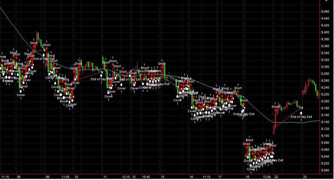

Inputs:price(close),N(54);
Variables:ma(0);
ma=Average(price,N);
if marketposition=0 and c<ma then
sellshort next bar market;
//end;(刪除)
if marketposition=-1 and c<=ma-10 then
buytocover next bar market;
//end;(刪除)
setexitonclose;
平靜的海 + 2 太強了
