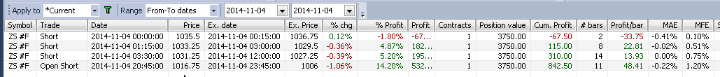

had a short sign
at 2014/11/04 01:00:00
short price is 1038
and the k bar high price is 1035
backtest result show this trade
It's wrong

 樓主| 發表於 14-11-6 11:19 | 顯示全部樓層
atrader 發表於 14-11-6 10:35
參考一下
Yahoo! Groups上buyprice不依help上的O,C的作法。
恩呀~ 這做法就是我在 8F裡寫的
Buy = (BuyPrice >= L);
Sell = (SellPrice <= H);
Short = (ShortPrice <= H);
Cover = (CoverPrice >= L);
我不確定這個問題是 BUG
或是個案
但我覺得
為了以防萬一
還是將買賣價設定在K線範圍的邏輯寫在買賣訊號中
不然就會像我再重新回測時
前後回測的結果差異大到你吐血崩潰

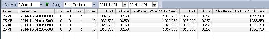

發表於 14-11-6 21:26 | 顯示全部樓層
There is no bug. The bug is that you don't understand.
Exploration for example does not support portfolio level functionalities.
You can only use single security backtester function Equity() there in exploration. That one (as it's name says - "single security backtester") does not support newer portfolio level backtester functionalities and some backtest settings supported only for portfolio level. for example priceboundchecking is not supported by Equity() function. Equity() was introduced in 4.40. Priceboundchecking was introduced in 4.45. Simply check development log.
If you wanna be smarter than TJ then contact him.
