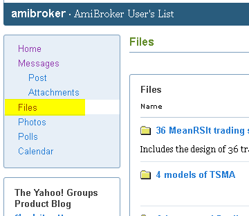

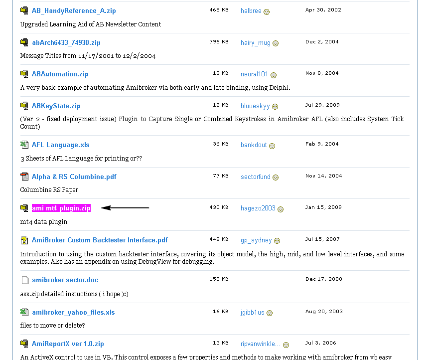

@keithlsp, don't know what you mean. The plugin is in the Files section of the Yahoo Amibroker group
The name of the file is ami mt4 plugin.zip

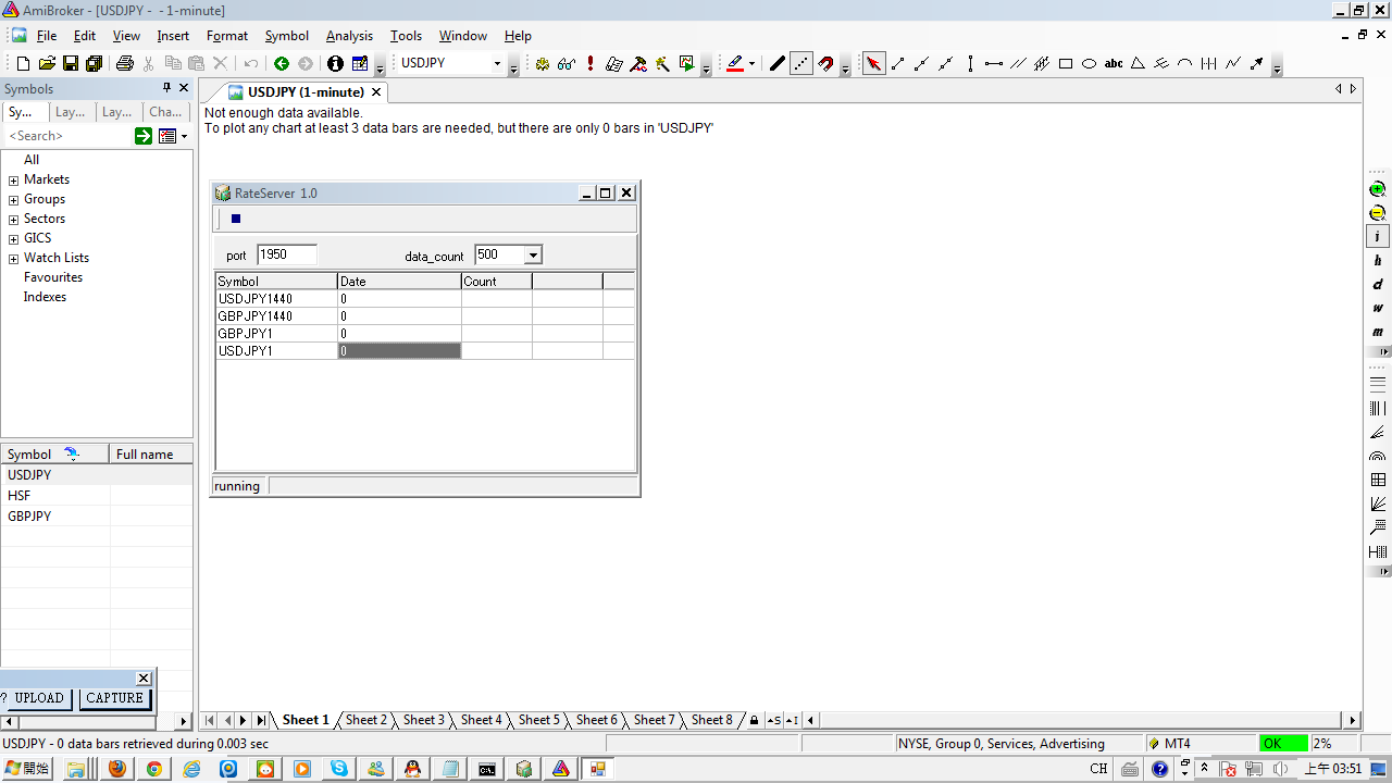

Thx joshsmi, I have found the MT4PlugIN, but, when I try to use it, I found that the rateserver have no data.
what is the meaning of "compile"
"click exp.mqh and compile"
many thanks!!

本帖最後由 joshsmi 於 12-9-21 06:02 編輯
Base time interval of Amibroker's data base settings must be the same as MT4's chart interval. So if you want to have 1 min data as lowest interval to import then choose M1 as MT4 chart interval and choose 1-minute in AB's data base settings.
And again, after backfill choose low data_count setting (10 to 50) in rateserver.

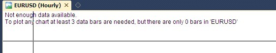

最少要有有3根K棒的資料才會顯示...
( AMIBROKER 圖上有說明)..
ami.jpg 也是這樣情況,請高手幫忙.謝謝!
補充內容 (12-11-22 08:20):
這個問題已解決!
