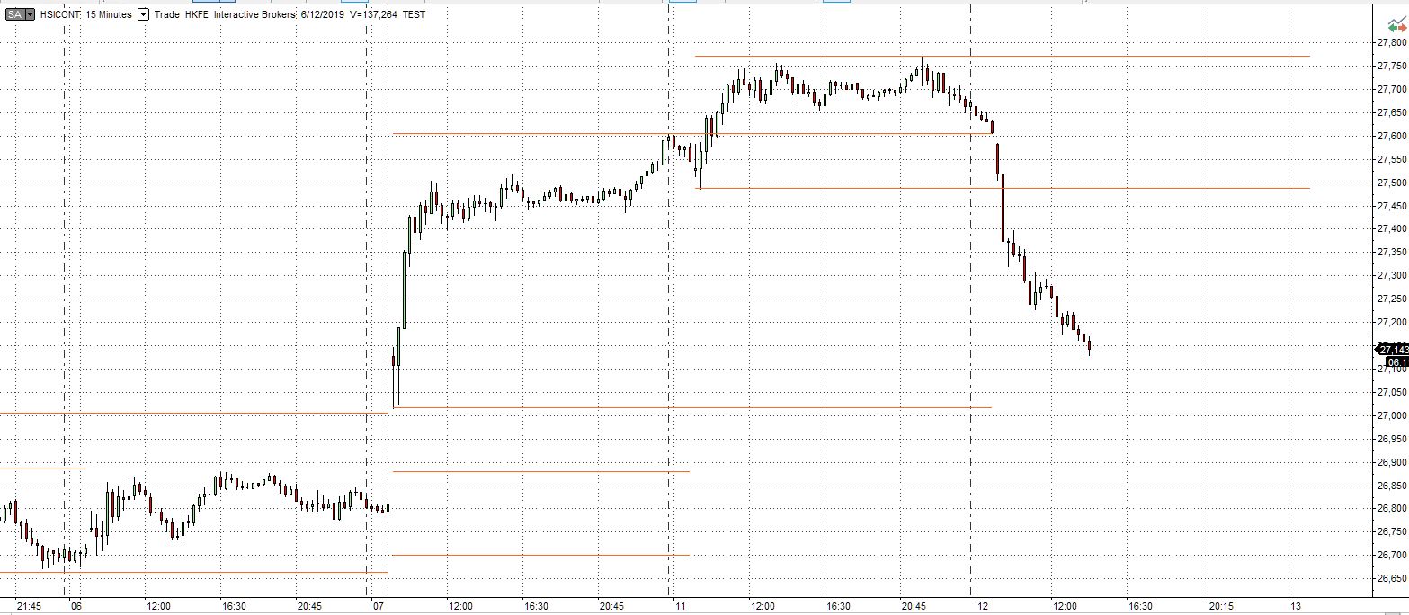

香港期指15分K圖如下:
Variables:
        DayChange                (False),
        DayUp                        (0),
        DayDown                (99999999);
If time = 0930 then
begin
        //print (date,"        ", time, "        ", DayUp ,"        ", DayDown );
        Value1 = TL_New(Date-1, 0930, DayUp , Date+1, 0100, DayUp );
        Value2 = TL_New(Date-1, 0930, DayDown , Date+1, 0100, DayDown );
        DayUp                =0;
        DayDown        =9999999999;
end;
if time > 0900 then
begin
        if High > DayUp then DayUp = High;
        if Low < DayDown then DayDown = Low;
end;
if DayChange = True and time <=0100 then
begin
        if time = 0100 then
        begin
                DayChange = False;
                //Print (Date,"        ",Time,"        ",DayUp,"        ", DayDown);
        end;
end;
if date <> date[1] then
begin
        DayChange = True;
end;
