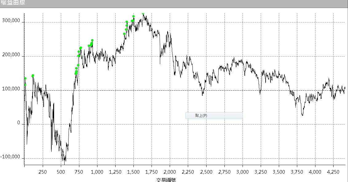

好人做到底,免得你浪費太多時間在這上面
input:start_time(0915),end_time(1600);
if time>start_time and time<end_time then begin
        if averagefc(close,5)>        averagefc(close,10) and averagefc(close,10)>averagefc(close,15) and averagefc(close,15)>averagefc(close,30) and close>averagefc(close,30) and averagefc(close,10)>averagefc(close,20) and averagefc(close,20)>averagefc(close,30) and averagefc(close,30)>averagefc(close,60) and close>averagefc(close,60) then begin
                buy next bar at market;
        end;
        if averagefc(close,5)<        averagefc(close,10) and averagefc(close,10)<averagefc(close,15) and averagefc(close,15)<averagefc(close,30) then begin
                sell next bar at market;
        end;
end;
不過我偷懶2分5ma,我改為1分鐘10ma替代,雖然會有點不同,但大同小異,不會差太多,這樣一個data就能搞定,除非寫出來是正向的,再去改data2為2分K來試試

這應該是恆生吧,這裡是台灣,要找人幫你寫恆生他得要有玩外期,有做外期的,你得付點實際的費用才請得到人幫你寫,如果台指可能還有人會幫你一下
這個策略,基本上是撈不到錢的
