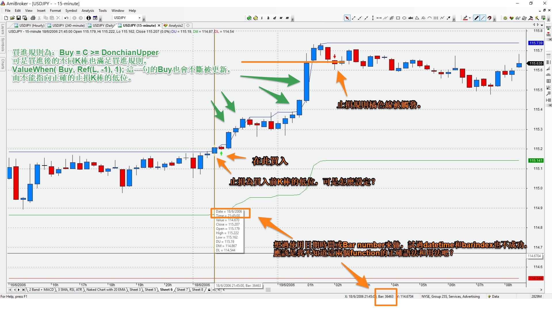

試過用valuewhen,可是在我回測的規則裡面,買進的規則在買進後會一直被觸發,所以valuewhen裡面的buysignal也會不斷被更新,不能指向實際買進之前的K棒。我這樣解釋好想比較難懂,附上截圖一張,上面有文字解釋。
另,我的測試原碼如下:
pds=60;
DonchianUpper =HHV(Ref(H,-1),pds);
DonchianLower = LLV(Ref(L,-1),pds);
DonchianMiddle = (DonchianUpper+DonchianLower)/2;
StopLoss = ValueWhen( Buy, Ref(L, -1), 1);
Buy = C >= DonchianUpper ;
Sell = C <= DonchianMiddle OR StopLoss ;
希望高手大大能指點一下,感謝!

問題出在
Sell = C <= DonchianMiddle OR StopLoss;

有幫你檢查過 ValueWhen 沒問題..
總之..改成下列即可
Sell = C <= DonchianMiddle OR C <= StopLoss; Sell=ExRem(Sell,Buy);

太感謝了!
我也想過用exrem去掉訊號,可是只有想過沒試過...
看了Keymaker大的頭像,跑去再看駭客任務了 :)
