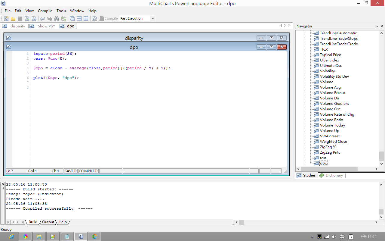

在下參考
plot1($disparity, "disparity");
另外弄一個dpo
eleader-fucntion
def dpo(period) :
        return c - ma(c,period)[((period / 2) + 1)]
inputs:period(36);
vars: $dpo(0);
$dpo = close - average(close,period)[((period / 2) + 1)];
plot1($dpo, "dpo");
可以用
dpo-mc-el
dpo-mc-el
dpo-mc
dpo-mc
dpo-eleader
dpo-eleader

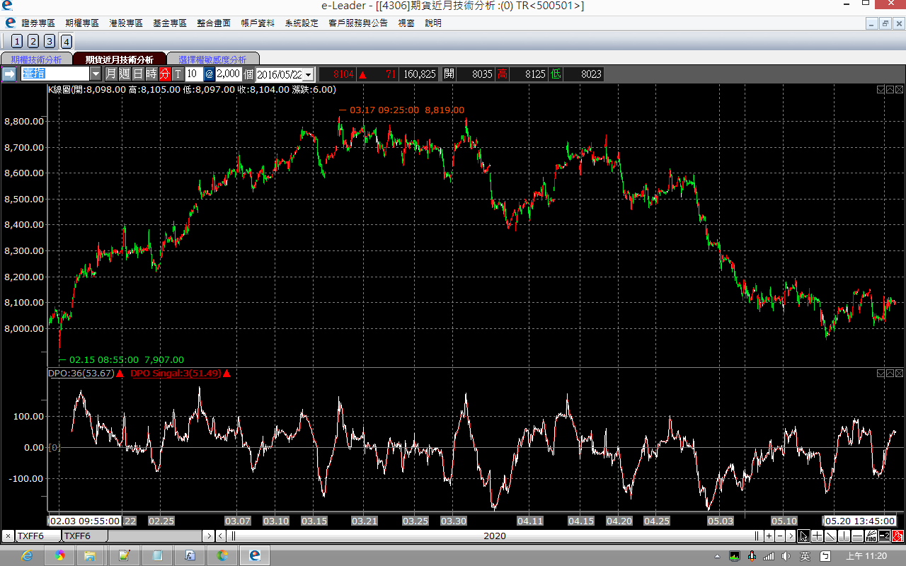

eleader內dpo
有多一條紅線dpo-singal
ema(dpo(36),3)
請問大大該如何補上這條ema線
感謝您!!

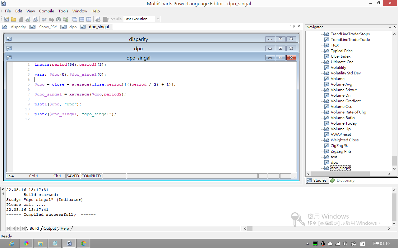

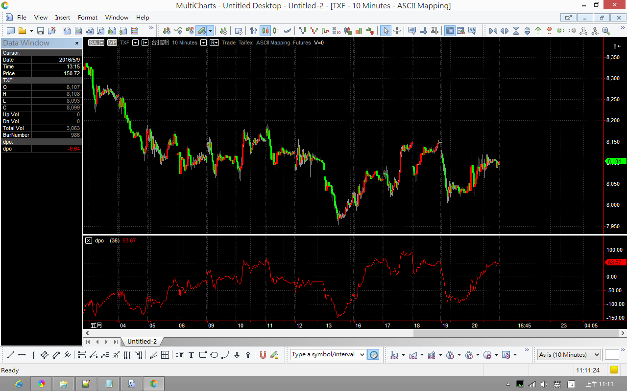

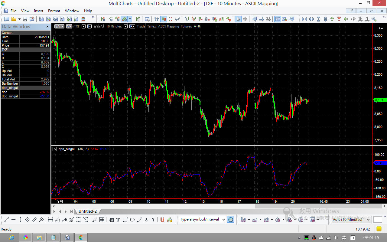

發表於 16-5-22 12:38 來自手機 | 顯示全部樓層
Ema 改為  Xaverage 的方式即可
 樓主| 發表於 16-5-22 13:23 | 顯示全部樓層
easytrader788 發表於 16-5-22 12:38
感謝您!!
可以用了!
  1. inputs:period(36),period2(3);
  2. vars: $dpo(0),$dpo_singal(0);
  3. $dpo = close - average(close,period)[((period / 2) + 1)];
  4. $dpo_singal = xaverage($dpo,period2);
  5. plot1($dpo, "dpo");
  6. plot2($dpo_singal, "dpo_singal");
複製代碼
感激不盡!!!

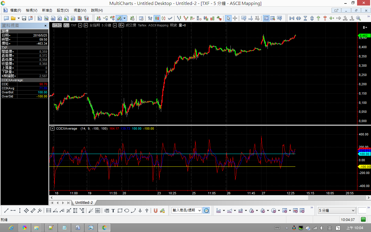

 樓主| 發表於 16-5-28 10:21 | 顯示全部樓層
本帖最後由 f29825604 於 16-5-28 10:25 編輯
f29825604 發表於 16-5-22 13:23
感謝您!!
可以用了!
自訂mc指標CCICXAverage
//    eleader-fucntion
def cci(period) :
        m1 = (h+l+c)/3
        m2 = ma(m1, period)
        d1 = array(len(m2) - period + 1)
        for i in range(period) :
                d1 = d1 + abs(m1 - m2)
        d1 = d1 / period
        return (m1-m2) / (0.015 * d1)
mc 內 CCIClassic[Buildin-Fucntion]
  1. Inputs: Len(NumericSimple);
  2. Variables: var0(0),var1(0),var2(0),var3(0), var4(0);
  3. If Len > 0 Then Begin
  4.         var4 = (High + Low + Close) / 3;
  5.         var3 = Average(var4 , Len);
  6.         var2 = 0;
  7.         for var1 = 0 to Len - 1 Begin
  8.                 var2 = var2 + AbsValue(var4[var1] - var3);
  9.         End;
  10.         var2 = var2 / Len;
  11.         If var2 = 0 Then
  12.                 CCIClassic = 0
  13.         Else
  14.                 CCIClassic = (var4 - var3) / (0.015 * var2);
  15. End
  16. Else
  17.         CCIClassic = 0;
複製代碼
新增CCICXAverage指標
用原本mc指標CCI Average修改
  1. inputs:
  2.         CCILength( 14 ),
  3.         CCIAvgLength( 9 ),
  4.         OverSold( -100 ),
  5.         OverBought( 100 ) ;
  6. variables:
  7.         var0( 0 ),
  8.         var1( 0 ) ;
  9. var0 = CCIClassic( CCILength ) ;
  10. var1 = XAverage( var0, CCIAvgLength ) ;
  11. Plot1( var0, "CCIC" ) ;
  12. Plot2( var1, "CCIXAvg" ) ;
  13. Plot3( OverBought, "OverBot" ) ;
  14. Plot4( OverSold, "OverSld" ) ;
  15. condition1 = var1 crosses over OverSold ;
  16. if condition1 then
  17.         Alert( "Indicator exiting oversold zone" )
  18. else
  19. begin
  20. condition1 = var1 crosses under OverBought ;
  21. if condition1 then
  22.         Alert( "Indicator exiting overbought zone" ) ;
  23. end;
複製代碼
可以用
做紀錄
可查詢
Thanks!!
