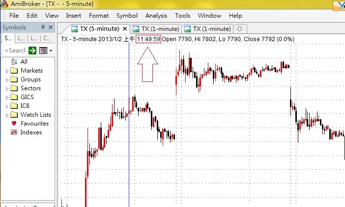

如同各位大大看到的這樣,為什麼我的AB的時間會少一秒,要怎麼更改呢??
少一秒會影響5分K和15分K的正確性,有人知道要怎麼解決嗎??
補充內容 (16-1-3 13:16):
我要的是他出現整數的秒數例如11:50:00,不要少1秒,這樣其他K線的計算標準會跑掉
補充內容 (16-1-3 13:33):
目前5分K的週期是8:46-8:49,8:50-8:54
我想要改成8:46-8:50,8:51-8:55,這樣可以嗎??

There is nothing strange about it. It just shows end time of bar interval.
A 5-minute bar goes for example from 11:45:00 - 11:49:59
Next bar would go from 11:50:00 to 11:54:59 etc.
If you want AmiBroker to show start time of interval then go to
Tools - Preferences - Intraday
 樓主| 發表於 16-1-3 13:11 | 顯示全部樓層
joshsmi 發表於 16-1-2 23:37
A 5-minute bar goes for e ...
I want 5-minute bar goes for example from 11:46:00 - 11:50:00
How to do that?

發表於 16-1-4 01:12 | 顯示全部樓層
Read this
http://www.amibroker.com/kb/2015/01/07/timestamps-explained/
and
http://www.amibroker.com/kb/2014 ... looking-timestamps/
AmiBroker use natural timestamping (no future offset).
Still you can shift back and forth as seen in second link.
