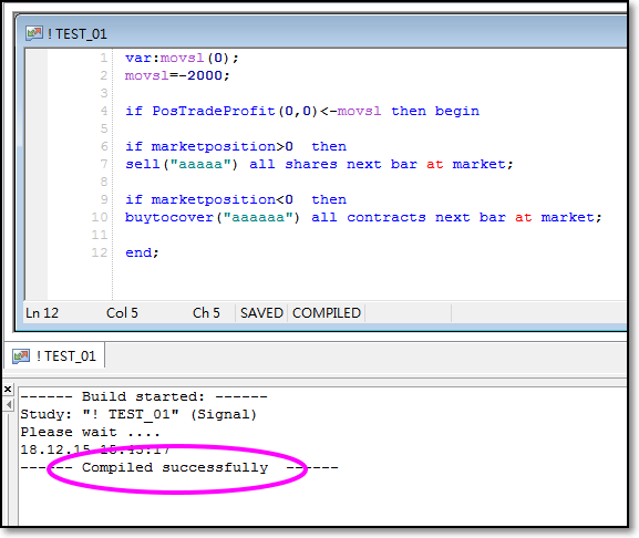

請問 PosTradeProfit(0,0)< - 變量 怎麼不可以使用? 哪邊寫錯了嗎?
var:movsl(0);
movsl=-2000;
if PosTradeProfit(0,0)<-movsl then begin
if marketposition>0  then
sell("aaaaa") all shares next bar at market;
if marketposition<0  then
buytocover("aaaaaa") all contracts next bar at market;
end;
發表於 15-12-18 15:46 | 顯示全部樓層
看起來,編譯是沒有問題的。
不會不能用吧。

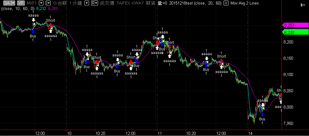

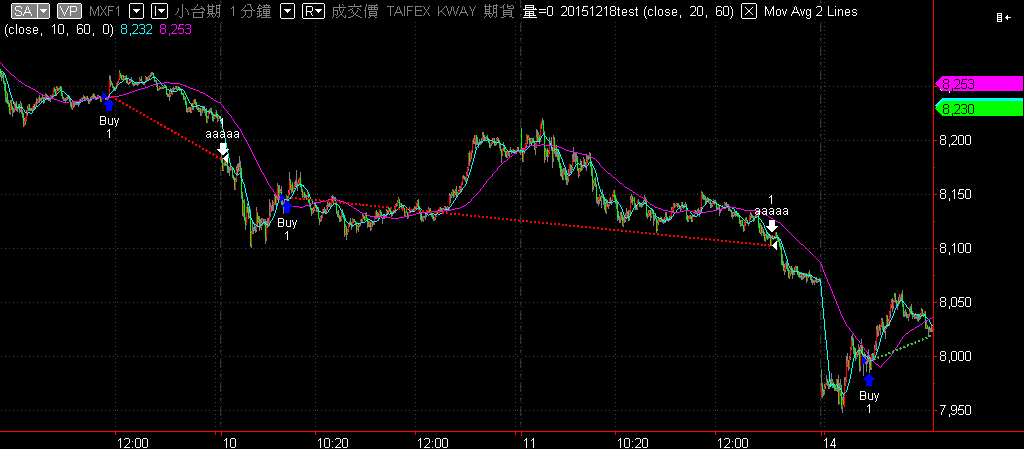

編譯是沒有問題,可是 2 個語法得出來的結果不一樣.
inputs:Price(close),Len_Short(5),Len_long(60);
vars:var1(0),var2(0);
var1 = AverageFC( Price, Len_Short) ;
var2 = AverageFC( Price, Len_long ) ;
if marketposition=0 and  var1  Crosses Above  var2 then begin
//buy("buy") next bar at market;
buy next bar at market;
end;
if marketposition=0 and  var1 Crosses Under  var2 then begin
//sellshort("sellshort") next bar at market;
sellshort next bar at market;
end;
var:movsl(0);
movsl=-2000;
//if PosTradeProfit(0,0)<-2000 then begin
end;
