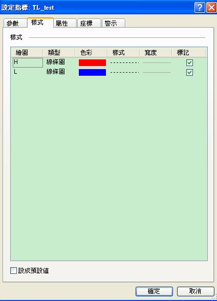

var:refH(0),refL(0),LongBody(False);
if absvalue(Open-close)>=100 then begin
refH=High;
refL=Low;
LongBody=True;
end;
if LongBody then begin
Plot1(refH,"H",yellow);
Plot2(refL,"L",Blue);
end;
