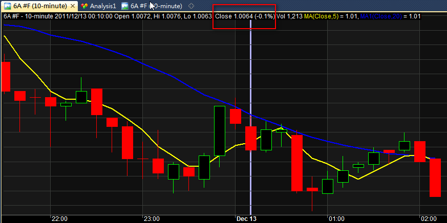

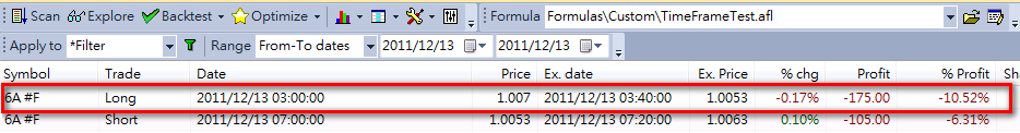

問題:
1.
以上面的回測跑出結果
取第一筆來實證
2.
3.
4.

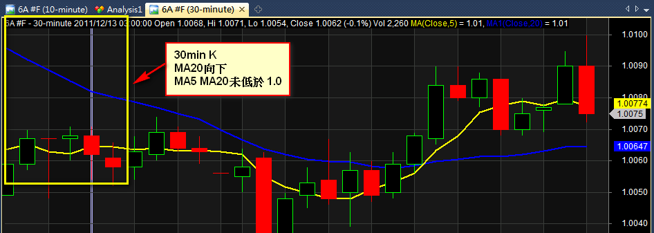

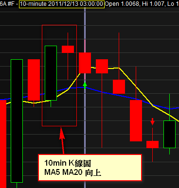

紅框符合圖2的情況
5.

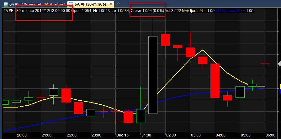

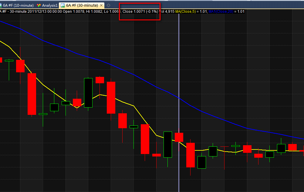

紅框符合圖2的情況
但是
黃框中
30分K的 前1根與前2根的MA5
居然是 0.8XXX
而對照圖3
明顯看出 MA5 並沒有在 1以下
6.
黃框中
30分K的 前1根與前2根的MA20
居然是 0.8XXX
而對照圖3
明顯看出 MA20 並沒有在 1以下
由 5 跟 6 的問題
導致回測的結果不正確
以上是我自己的測試結果
還請各位先進指導
感謝~

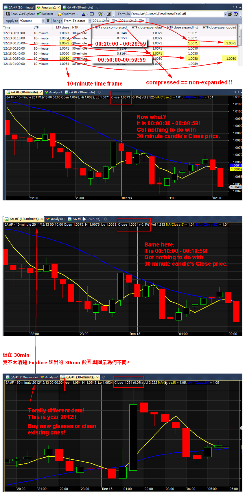

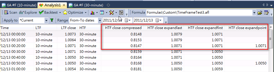

You have forgottten timeframeexpand! It has three expand option: expandlast,expandfirst,expandpoint.
Code not tested! There could be other bugs in your code.

  22. MA5 = int ( MA ( C, 5 ) * roundNum + 0.5 ) / roundNum; // MA5 rounded to the fourth decimal point
  23. MA5_P1 = Ref ( MA5, -1 ); // before a K rod MA5
  24. MA5_P2 = Ref ( MA5, -2 ); // before 2 K rod MA5
  25. Cond_MA5_P1_Buy = MA5_P1 > MA5_P2; // Buy
  26. Cond_MA5_P1_Short = MA5_P1 < MA5_P2; // Short
  27. MA20 = int ( MA ( C, 20 ) * roundNum + 0.5 ) / roundNum; // MA20 rounded to the fourth decimal point
  28. MA20_P1 = Ref ( MA20, -1 ); // rod before a K MA20
  29. MA20_P2 = Ref ( MA20, -2 ); // 2 K bar before MA20
  30. Cond_MA20_P1_Buy = MA20_P1 > MA20_P2; // Buy
  31. Cond_MA20_P1_Short = MA20_P1 < MA20_P2; // Short
  32. htf = 30 * 60;
  33. TimeFrameSet (htf); // switch to the 30 minutes of the K line graph
  34.     MA5_30min = int (MA (C, 5) * roundNum + 0.5) / roundNum; // MA5 rounded to the fourth decimal point
  35.     MA5_P1_30min = Ref (MA5_30min, -1); // before a K rod MA5
  36.     MA5_P2_30min = Ref (MA5_30min, -2); // before 2 K rod MA5
  37.     MA20_30min = int (MA (C, 20) * roundNum + 0.5) / roundNum; // MA20 rounded to the fourth decimal point
  38.     MA20_P1_30min = Ref (MA20_30min, -1); // rod before a K MA20
  39.     MA20_P2_30min = Ref (MA20_30min, -2); // before 2 K rod MA20
  40. TimeFrameRestore (); // reply to 10 K line graph
  41. expandoption = expandpoint;
  42. MA5_P1_30min = TimeFrameExpand( MA5_P1_30min, htf, expandoption );
  43. MA5_P2_30min = TimeFrameExpand( MA5_P2_30min, htf, expandoption );
  44. MA20_P1_30min = TimeFrameExpand( MA20_P1_30min, htf, expandoption );
  45. MA20_P2_30min = TimeFrameExpand( MA20_P2_30min, htf, expandoption );

 樓主| 發表於 14-10-8 09:52 | 顯示全部樓層
joshsmi 發表於 14-10-7 23:00
Simply use exploration to understand what compress without expand means and what each expand option  ...
joshsmi 大感謝您的回覆
您第一個改寫我原先的範例後
我跑了一下
但在30min 跑出來的值有疑問
您第二個程式碼
我跑出來
一樣對30min 的值有疑問
就一起跟您請教了
以下就是以您第二個範例來跑的

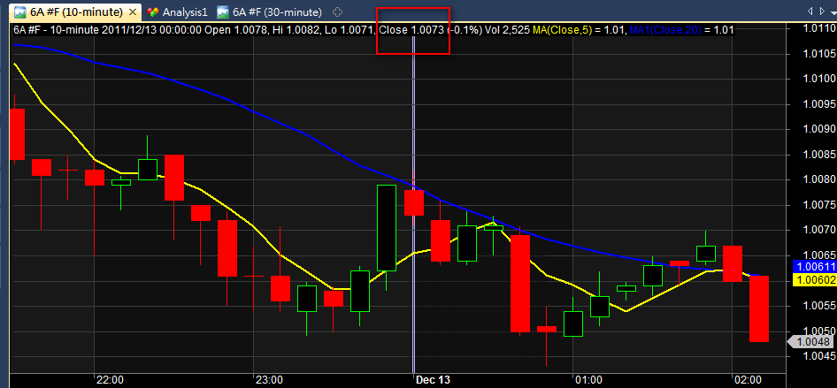

2011/12/13:00:00:00
2011/12/13:00:10:00
在10min 顯示的Close 價格是對的
但在 30min
我不太清楚 Explore 跑出的 30min 數值 與圖示為何不同?
發表於 14-10-8 16:01 | 顯示全部樓層
本帖最後由 joshsmi 於 14-10-8 16:03 編輯
skyler 發表於 14-10-8 09:52
joshsmi 大感謝您的回覆
I don't know where you went to school but it is actually very simple and very easy to understand.
See responses in picture
skyler + 2 Thanks
 樓主| 發表於 14-10-8 19:01 | 顯示全部樓層
本帖最後由 skyler 於 14-10-8 19:03 編輯
joshsmi 發表於 14-10-8 16:01
Dear joshsmi
It's my mistake
I already understand.
Thanks your help.
