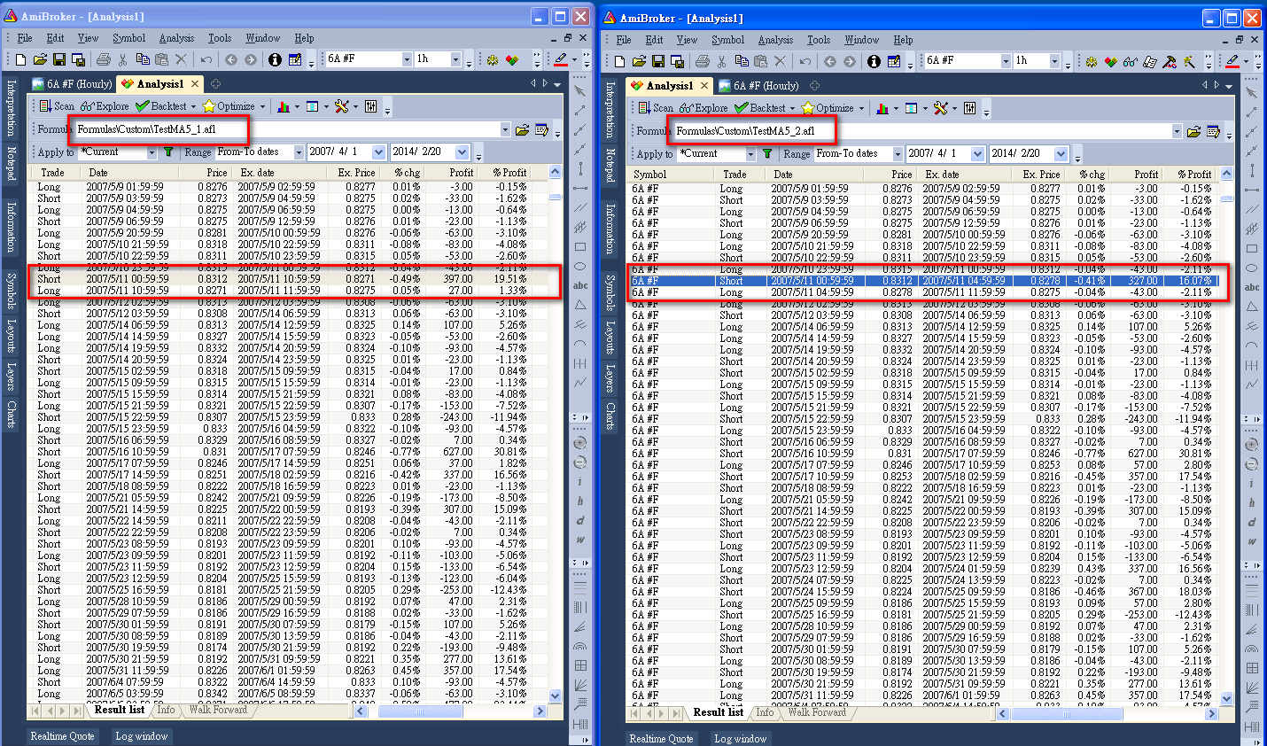

想法:
前一根K棒判斷,符合條件,本根K棒開盤下單
Buy : K棒 MA5 均線向上 且K棒向上穿過MA5
Sell : MA5均線向下
Short : MA5 均線向下 且K棒向下穿過MA5
Cover : MA5均線向下
測試標的: 6A #F 1小時線
實作二個 afl1. TestMA5_1.afl
在迴圈前先將判斷式寫好
程式碼如下 :
_SECTION_BEGIN( "Product Settings" );
SetPositionSize( 1 , spsShares );
SetOption( "MaxOpenPositions" , 1 );
SetOption( "InitialEquity" , 10000 );
SetOption( "FuturesMode" , 1 );
SetOption( "CommissionMode" , 3 );
SetOption( "CommissionAmount" , 6.5 );
RoundLotSize = 1;
if ( Name () == "6A #F" )
    TickSize = 0.0001 ;
    MarginDeposit = 2035 ;
    PS = 10000;
    PointValue = 10 * PS;
_SECTION_END();
MA5_P1 = Ref( MA( C, 5 ), -1 );     //前一根的 MA5
MA5_P2 = Ref( MA( C, 5 ), -2 );     //前二根的 MA5
Cond_MA5_Buy = MA5_P1 > MA5_P2;  //前一根的MA5 > 前二根的MA5 表示 MA5在前一根是向上
Cond_MA5_Sell = MA5_P1 < MA5_P2;  //前一根的MA5 < 前二根的MA5 表示 MA5在前一根是向下
Cross5_Buy =  Cross ( Ref( C, -1 ), MA5_P1 );    //前一根K棒向上穿過MA5
Cross5_Sell = Cross ( MA5_P1, Ref( C, -1 ) );     //前一根K棒向下穿過MA5
BuyIndex = 0;    //判斷是否有多單
ShortIndex = 0;    //判斷是否有空單
for ( i = 0 ; i < BarCount ; i++ )
    //Buy
    if ( BuyIndex == 0 )
        if ( Cond_MA5_Buy AND Cross5_Buy )
            BuyIndex = i;
            Buy = 1;
            BuyPrice  = O ;
    //Sell
    if ( BuyIndex != 0 )
        if ( Cond_MA5_Sell  )
            BuyIndex = 0;
            Sell = 1;
            SellPrice = O ;
    //Short
    if ( ShortIndex  == 0 )
        if ( Cond_MA5_Sell AND Cross5_Sell )
            ShortIndex = i;
            Short = 1;
            ShortPrice = O ;
    //Cover
    if ( ShortIndex != 0 )
        if ( Cond_MA5_Buy )
            ShortIndex = 0;
            Cover = 1;
            CoverPrice = O ;
2. TestMA5_2.afl
在迴圈內逐一判斷
程式碼如下 :
RoundLotSize = 1;
    TickSize = 0.0001 ;
    PS = 10000;
_SECTION_END();
MA5 = MA( C, 5 );  //MA5
Cross5_Buy =  Cross ( C, MA5 );    //K棒向上穿過MA5
Cross5_Sell = Cross ( MA5, C );     // K棒向下穿過MA5
for ( i = 2 ; i < BarCount ; i++ )
    //Buy
        if ( MA5 [i-1] > MA5[i-2] AND Cross5_Buy[i - 1] )  //前一根MA5 > 前二根MA5  且
        {                                                                        // 前一根K棒向上穿過MA5
            BuyIndex = i;
            Buy = 1;
            BuyPrice  = O ;
    //Sell
        if ( MA5 [i-1] < MA5[i-2] )                        //前一根MA5 < 前二根MA5
            BuyIndex = 0;
            Sell = 1;
            SellPrice = O ;
    //Short
        if ( MA5 [i-1] < MA5[i-2]  AND Cross5_Sell[i-1] )        //前一根MA5 < 前二根MA5  且
        {                                                                             // 前一根K棒向下穿過MA5
            ShortIndex = i;
            Short = 1;
            ShortPrice = O ;
    //Cover
        if ( MA5 [i-1] > MA5[i-2] )                                      //前一根MA5 > 前二根MA5
            ShortIndex = 0;
            Cover = 1;
            CoverPrice = O ;

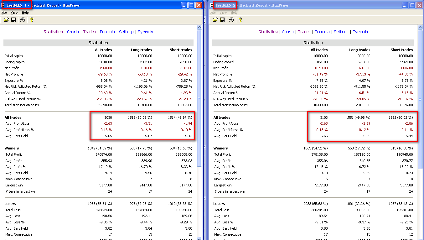

二者跑出來的結果不同
所以想請教一下先進自己的盲點在那
感謝~  (鞠躬)
