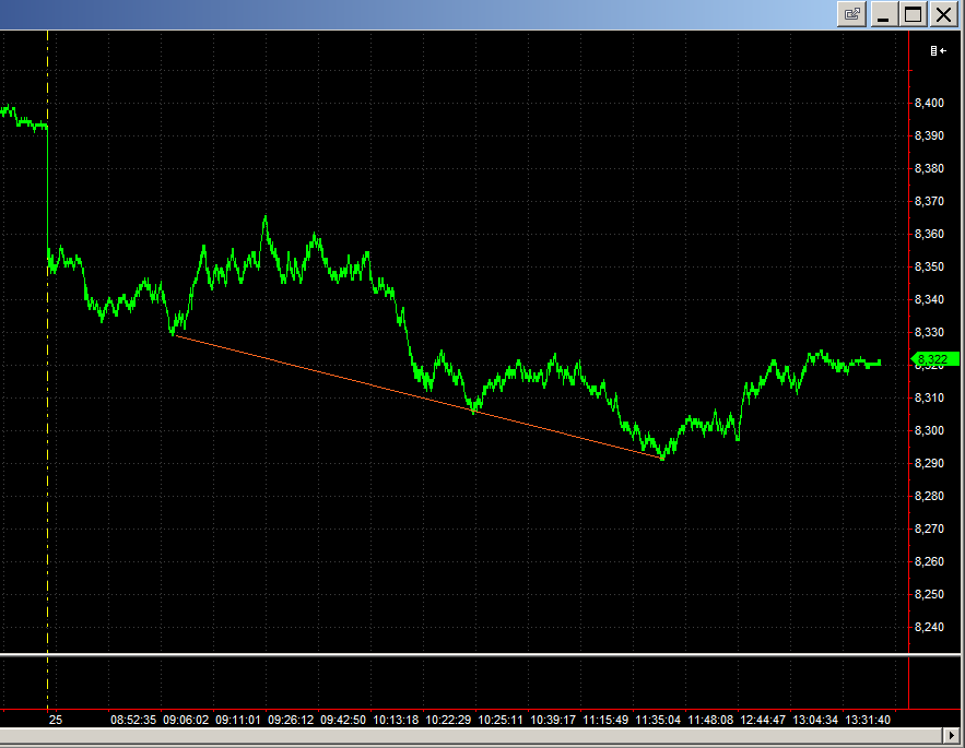

發表於 13-10-25 09:02 | 顯示全部樓層 |閱讀模式
人工定2點連成一條趨勢線,以多單來說,沒跌破就續抱,跌破就賣出,這要怎麼做到呢?

程式碼只有一行, 填入兩點的時間和價格即可.
value1= TL_New(Date,0908,8329,Date,1142,8291);

What's that Power Language junk got to do with AmiBroker????
The same can be done in AmiBroker with simple functions either with AFL or in dll plugin.
Here is AFL equivalent to that TS trendline function
// Copyright joshsmi, Oct 2013
function dntn2dt( dn, tn )
// Datenum() + Timenum() to DateTime()
return DateTimeConvert( 2, dn, tn );
function TL_New( dn1, tn1, startval, dn2, tn2, endval )
// trendline function
    dt      =
DateTime();
    bi      =
BarIndex();
    startdt = dt == dntn2dt( dn1, tn1 );
    enddt   = dt == dntn2dt( dn2, tn2 );
    x0      =
LastValue( ValueWhen( startdt, bi ) );
    x1      =
LastValue( ValueWhen( enddt, bi ) );
    y0      =
LastValue( ValueWhen( startdt, startval ) );
    y1      =
LastValue( ValueWhen( enddt, endval ) );
    Line    =
LineArray( x0, y0, x1, y1, 1, True );
return Line;
Plot( C, "C", colorWhite, styleCandle );
Plot( TL_New( 1131028, 090000, L, 1131028, 130500, L ), "Trend line", colorRed );
And this is how it looks
