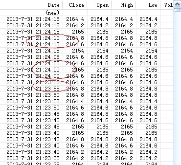

如圖:疑問AB存儲tick每隔5秒,請問對方交易平臺行情每秒推送2個TICK。
存儲時間與行情過來的時間會對不上嗎。還有按平臺方5秒有10TICK的問題?

在Time Sales窗口
每秒都有TICK
不知在QE中,會每5秒存儲。

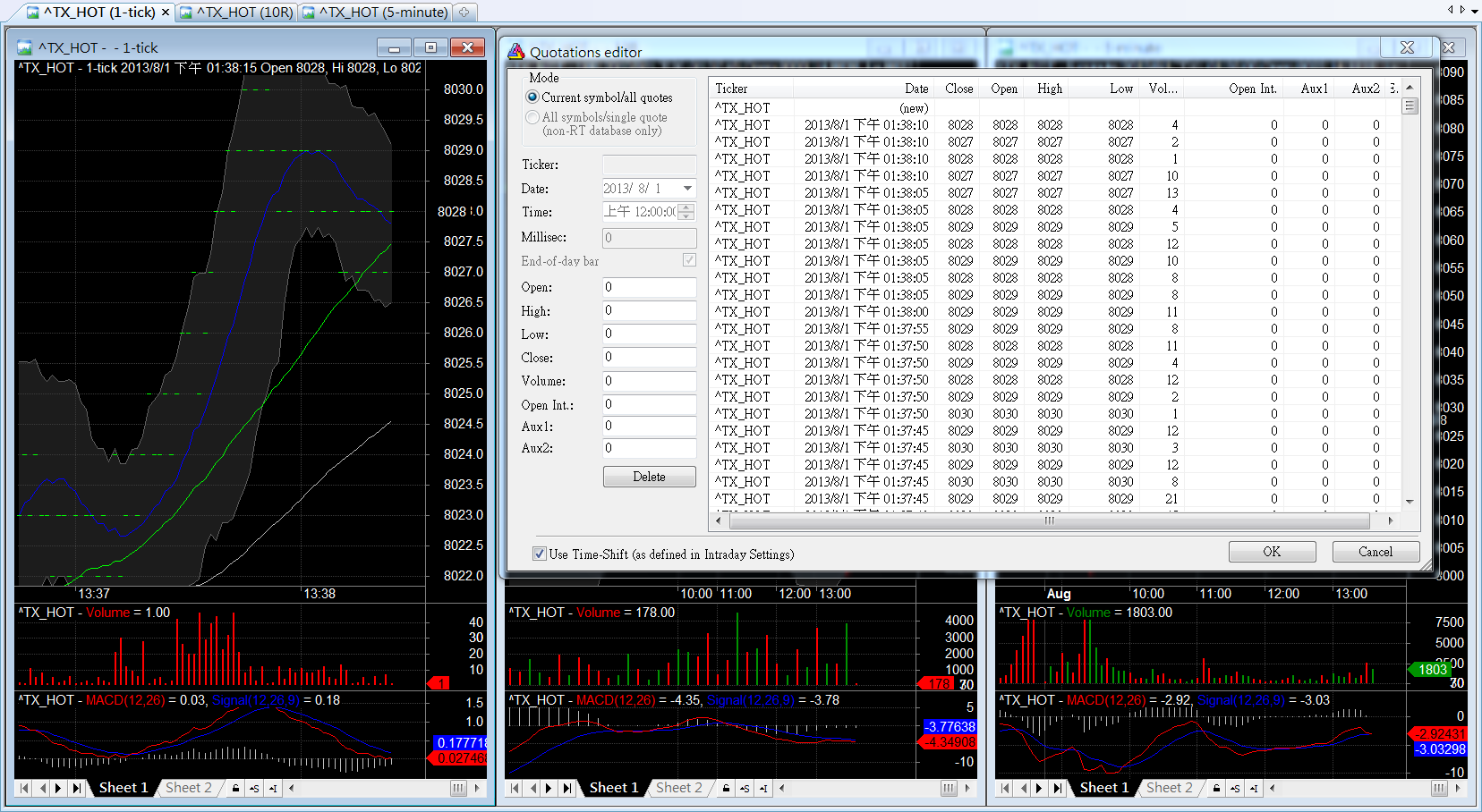

最近也發現在 tick mode 最小單位是 5秒..
不過如果是不使用 real-time plug-in (在 Information ->Use only local database 設為 YES) 的情形下.
resolution 可以到 1s
但是只要把上述設定改 No,所有的 tick data 就會改成最小單位是5秒
我的報價來源是 xDdeSvr + 富邦e01,有觀察過tick 頻率是低於5秒的..
AB 是 5.60.3
有圖有真相:
左邊是 tick 圖,也是以5秒為單位

我用的是 32-bit Amibroker
配合 XDdeSvr 的 plug-in 是內建的 "DDE universal data plug-in"
(XDdeSvr 是取自本版的置頂文...)
看起來是 32-bit 與 64-bit 的差異..
在以下這篇文章有提到..
http://finance.groups.yahoo.com/group/amibroker/message/101066
====(quote) =====
I asked this question of AB support some time ago.
This is the response I got:
"This is due to the fact that AmiBroker uses its own 32-bit datestamp
that has resolution of 5 seconds but spans years of 1900-2155.
Standard C-language 32-bit timestamp that has resolution of 1-second is
limited to dates from 1970-2023 and therefore can not be used
(year range is to narrow).
However this does not really affect anything as all ticks are imported,
order of ticks is maintaned and all charts look correct and all
analysis is accurate."
Note that I only have the standard version of AB so I am unsure if it
is different for the professional version.
=====(unquote)=======
這問題到 64-bit 版本應該就解決了...
