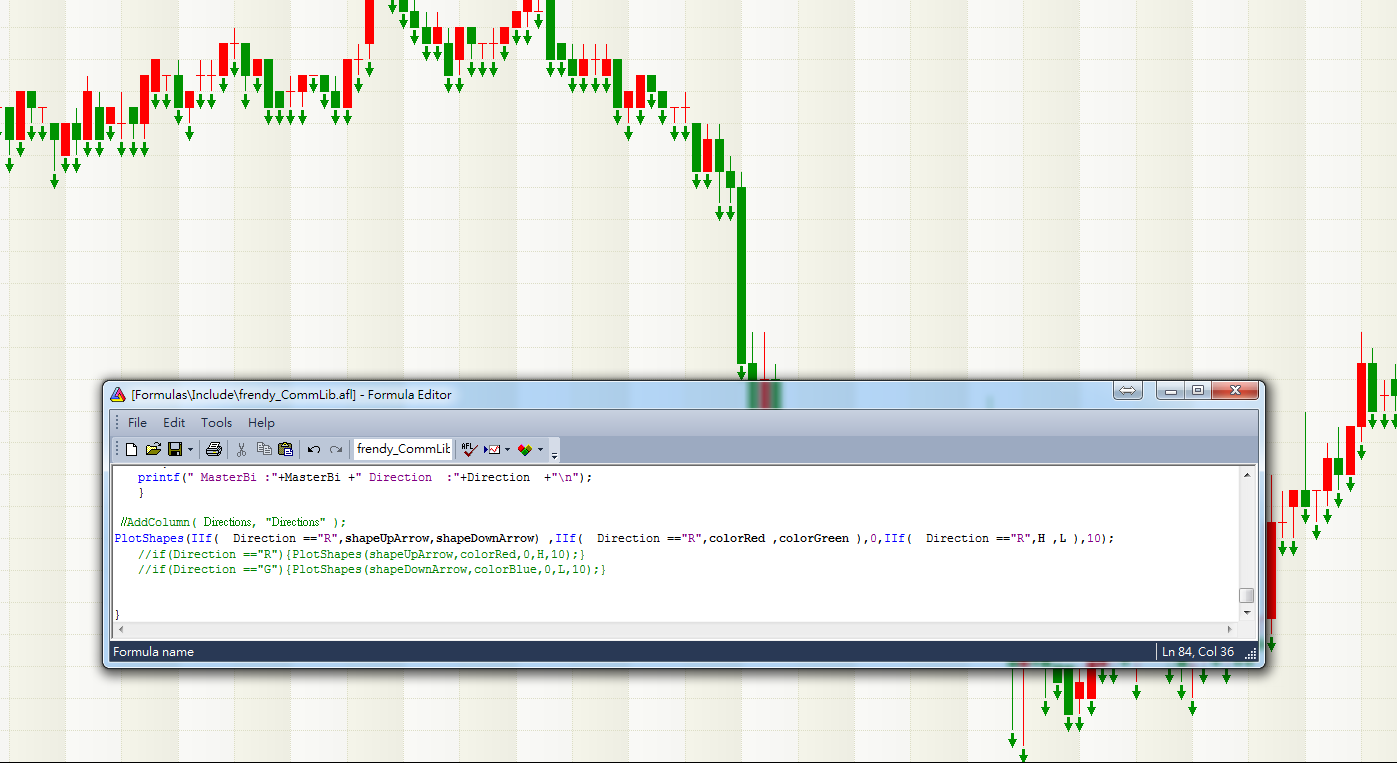

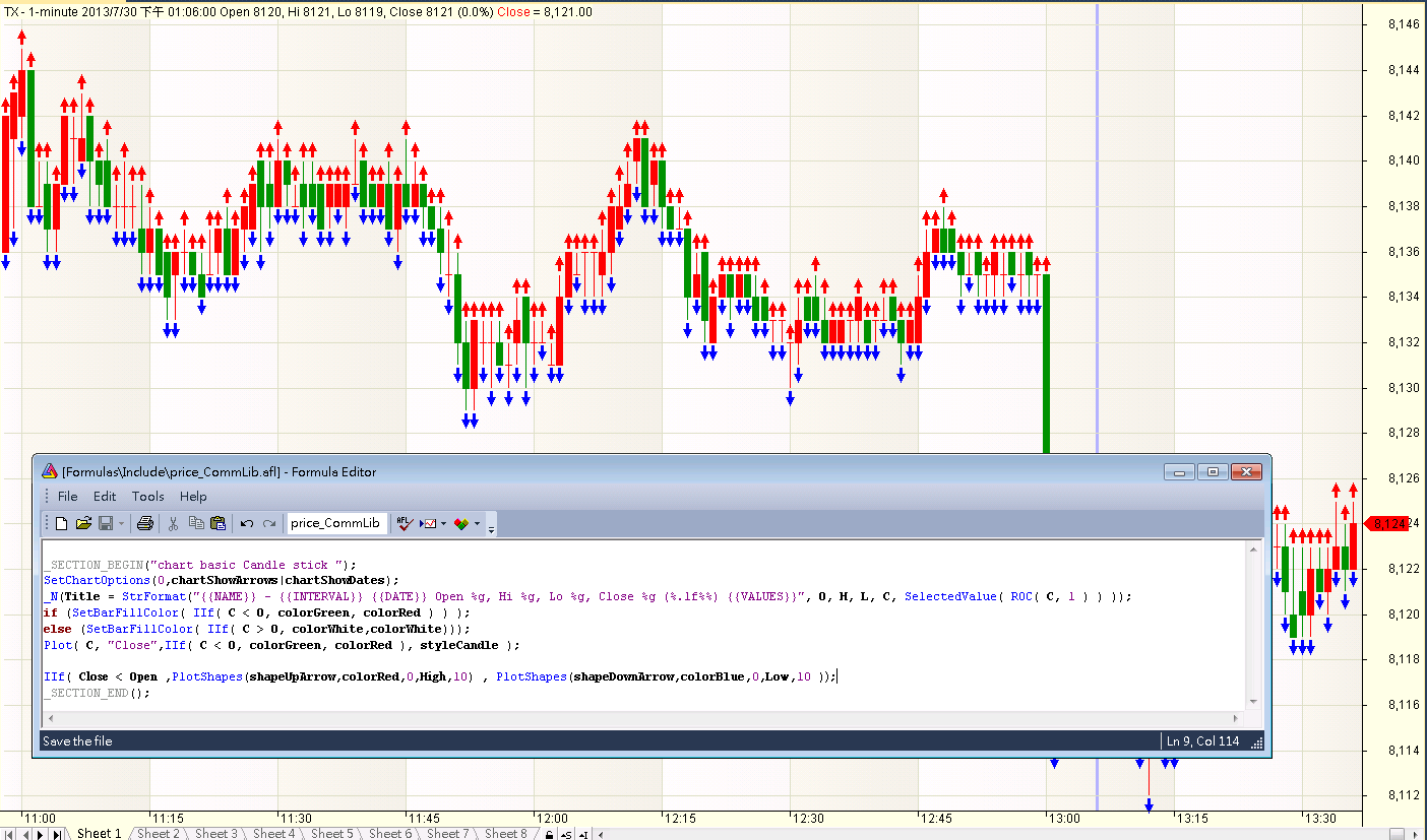

請問想在ab的圖上
當紅k時,畫一個向上的arrow
當黑k時,畫一個向下的arrow
就理解上 加了這行code...
IIf( Close > Open ,PlotShapes(shapeUpArrow,colorRed,0,High,10) , PlotShapes(shapeDownArrow,colorBlue,0,Low,10 ));
但為何出現了如圖的清況呢?
plotshapes
plotshapes
謝謝
也有用簡單的if else .. 但出來也是跟著點選的kbar 跑
發表於 13-7-30 20:23 | 顯示全部樓層
用法錯誤....
參考 http://www.amibroker.com/guide/afl/iif.html
Please note that IIF is a function - so the result of evaluation is returned by that function and should be assigned to some variable. IIf always evaluates both TRUE_PART and FALSE_PART, even though it returns only one of them. Because of this, you should watch for undesirable side effects. The following example shows one common error made with IIF function: IIF( condition, result = 7, result = 9 ); // THIS IS WRONG Correct usage is: result = IIF( condition, 7, 9 ); /* 7 or 9 is *returned* and assigned to a variable depending on condition */
發表於 13-7-30 20:46 | 顯示全部樓層
所以可行的做法如下
PlotShapes ( IIf( Close > Open, shapeUpArrow, shapeDownArrow), IIf( Close > Open, colorRed, colorGreen),0, IIf( Close > Open, Low-1,High+1));

發表於 13-7-30 21:27 | 顯示全部樓層
看妳的附圖 你要的好像是這樣
PlotShapes ( IIf( Close > Open, shapeUpArrow, shapeDownArrow), IIf( Close > Open, colorRed, colorGreen),0, IIf( Close > Open, HIGH+12,low-12));

貼全文來看看....

本帖最後由 altubers 於 13-7-30 22:03 編輯
  1. function getNum(_value){
  2.         biString = NumToStr(_value);
  3.         return  StrToNum(biString );
  4. }
  5. function getDirection(){
  6.     MAD  =  getNum( MA(C,10) < MA(C,30));
  7.     VAD  =  getNum(  MA(V,10) < MA(V,30));
  8.      //printf(" MAD  :"+MAD  +" VAD  :"+VAD  +"\n");
  9.     Direction  =   "N";
  10.     if(MAD  ==VAD   ) Direction  =   "R"; else Direction  =   "G";
  11.     //printf(" Direction  :"+Direction  +"\n");
  12.     PlotShapes(IIf(  Direction =="R",shapeUpArrow,shapeDownArrow) ,IIf(  Direction =="R",colorRed ,colorGreen ),0,IIf(  Direction =="R",H ,L ),10);
  13. }
複製代碼
目前測試是拿ma 和mv來計算…arrow到是隨著點到的k bar而改變
在寫的時後還有另一個問題就是
  1. MSD =MA(C,10) < MA(C,30)
複製代碼
這時後 If(MSD) 確會是錯的... MA(C,10) < MA(C,30) 不是 bool 還真不習慣~~
