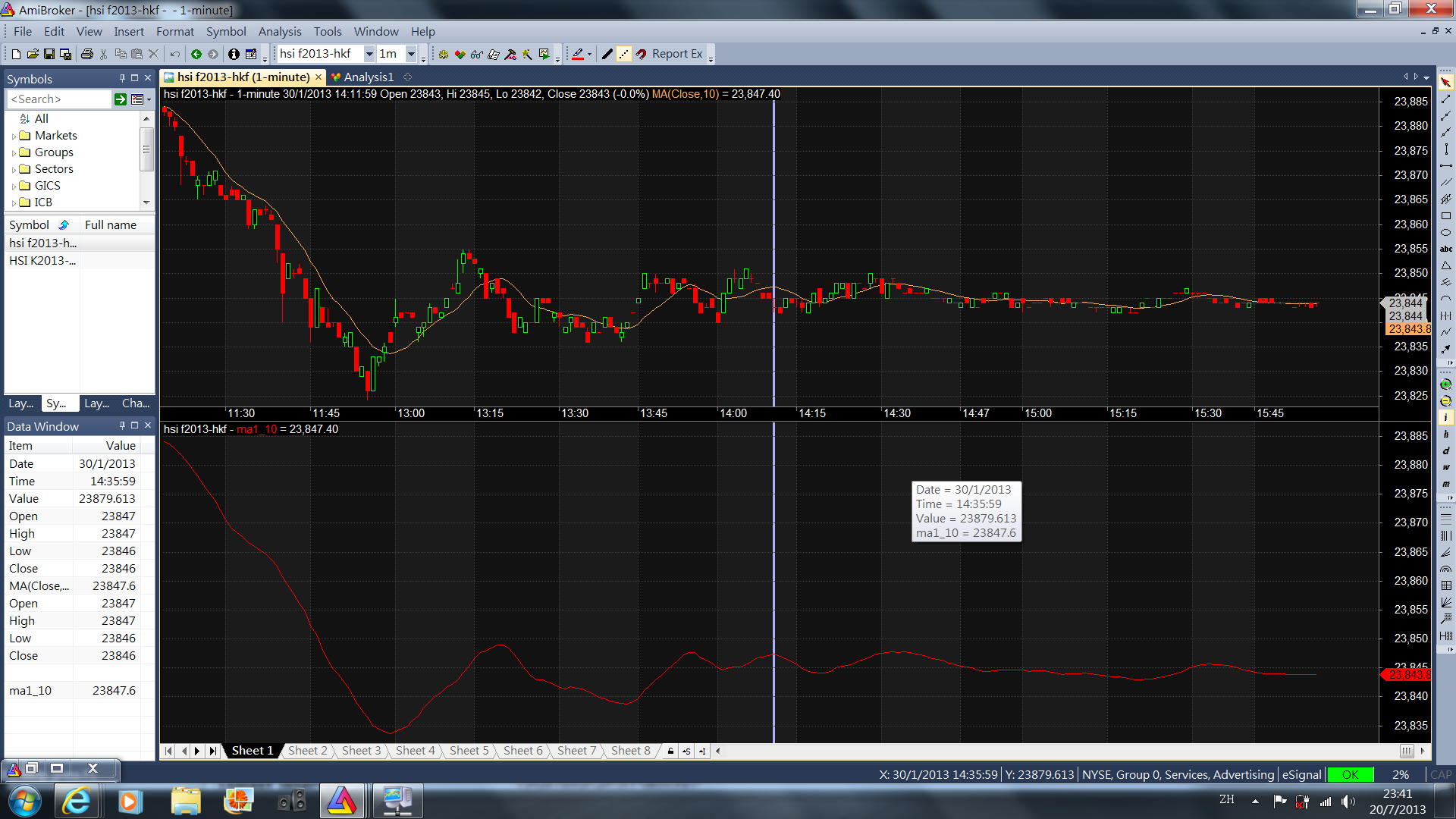

1min
1min
1min

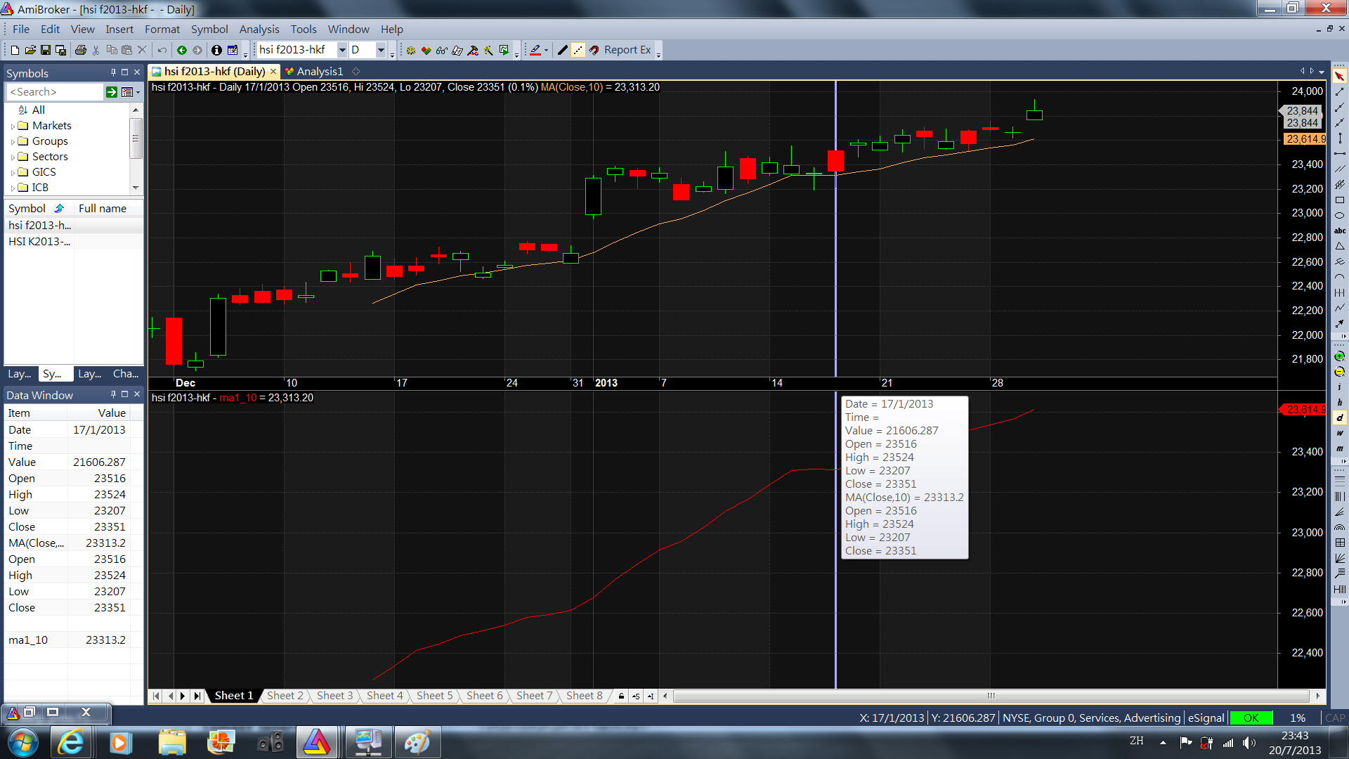

if i change to daily , the MA1_10 will follow to change.
daily
daily
根據上圖, 看來沒有timeframeset 也好像ok , 請問timeframeset 用在什麼地方上?
