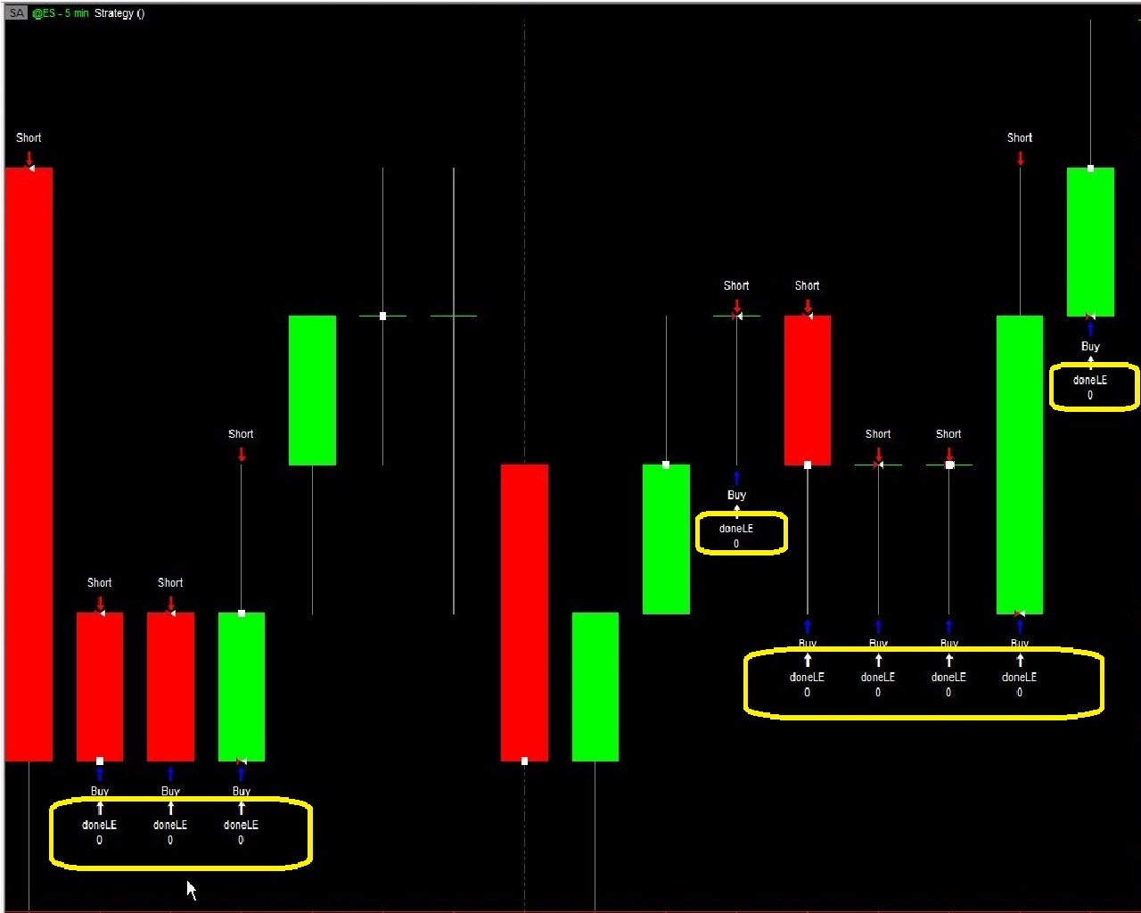

我試著寫只要510就出場,但跑出來的結果卻顯示每根K棒的出場訊號都是doneSE和doneLE,好像每根K都是time=510,不知道我邏輯哪裡錯誤了?
if marketposition=0  and  (Time >610) or (Time < 500) then begin
if marketposition<>-1 then sellshort next bar market;
If marketposition<>1 then buy next bar market;
end;
If time=510 AND MarketPosition <> 0 Then
Sellshort("doneSE") next bar market;
Buytocover("doneLE") next bar market;
