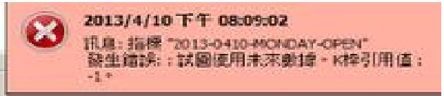

其實我也嘗試把上述程式碼改為
if D <> D[-1]  and  open[-1]  > Close and dayofweek(D) = 5 then
buy next bar at market;
但得錯誤訊息:
"試圖使用未來數據, k棒引用值-1"

D[-1]在PL可以編譯得過, 但在MC卻不能引用...我覺得這應該算是MC的bug,
anyway, 改用D next bar, D tomorrow應該是ok的.
OHLC用[-1]好像就都沒有問題, 但還是要注意假聖杯的問題.

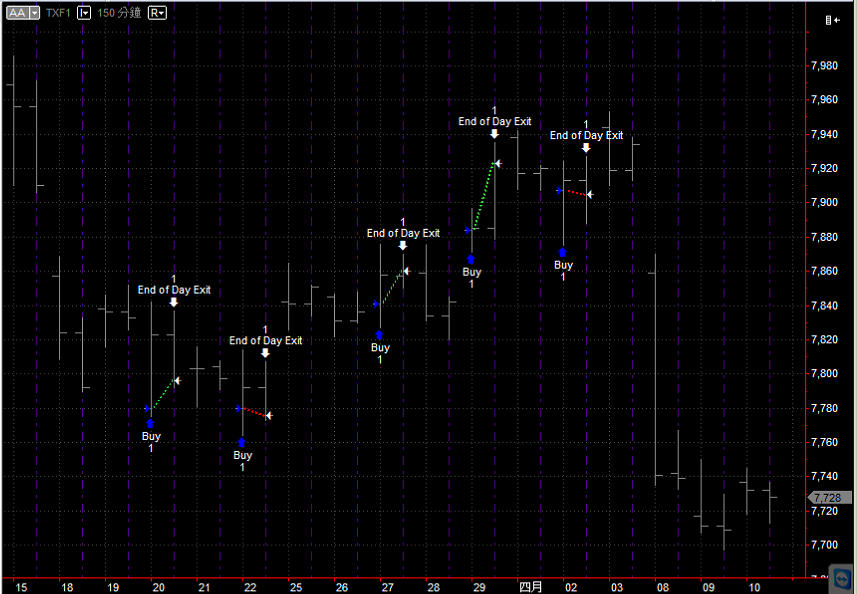

if D <> D next bar and Open[-1] < Close[-1] then buy next bar market;
setexitonclose;
