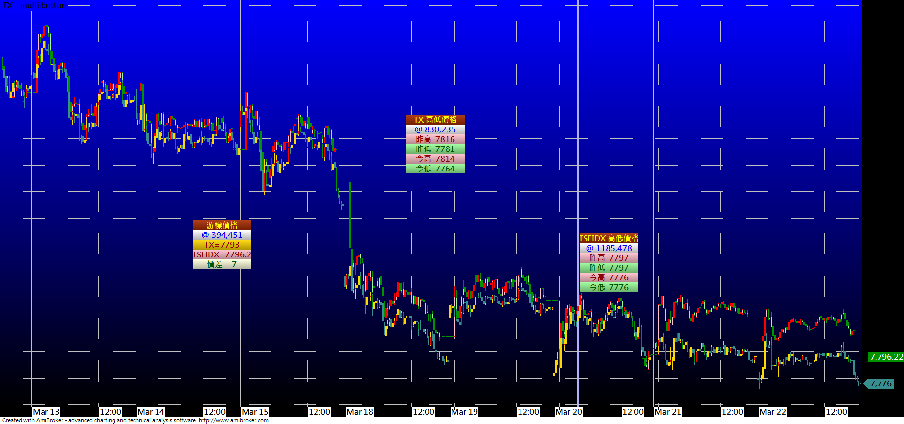

發表於 13-3-22 22:49 | 顯示全部樓層 |閱讀模式
純粹好玩

  330. {
  331. PanelYoffset =ButtonHeight1+ButtonHeight2;// Param("Button Row Offset (px)",60,0,600,1);
  332. StaticVarSet("ON3_color", colorGrey50);
  333. }
  334. else
  335. {
  336. PanelYoffset =pxH-StaticVarGet("C3_Y");
  337. if (PanelYoffset<5)
  338. {
  339. PanelYoffset =5;
  340. }
  341. }
  342. ButtonHeight=ButtonHeight3;
  343. ButtonWidth=ButtonWidth3;
  344. FontRatio=FontRatio3;
  345. ButtonColumnBegin("3", "微軟正黑體", FontRatio, ButtonHeight) ;
  346. ButtonHeader(Ticker+" 高低價格", colorDarkGreen, colorBrown,colorYellow);
  347. C302=ButtonTrigger("@ "+NumToStr(PanelXoffset+ButtonWidth3*2,1.0,False)+","+NumToStr(PanelYoffset,1.0,False),ON3_color, colorWhite , colorBlue);
  348. ButtonText( "昨高 "+NumToStr(TYesTH[BarCount-1],1.0,False), colorPink, colorDarkRed);
  349. ButtonText( "昨低 "+NumToStr(TYesTL[BarCount-1],1.0,False), colorPaleGreen, colorDarkGreen);
  350. ButtonText( "今高 "+NumToStr(TTodayH[BarCount-1],1.0,False), colorPink, colorDarkRed);
  351. ButtonText( "今低 "+NumToStr(TTodayL[BarCount-1],1.0,False), colorPaleGreen, colorDarkGreen);
  352. ButtonColumnEnd(ButtonWidth3);
  353. ClickCoordinates = Nz(StaticVarGet("ClickCoordinates"));
  354. switch(ClickCoordinates)
  355. {
  356. case 301:
  357. Say( "Ticker");
  358. break;
  359. case 302:
  360. if (C302)
  361. {
  362. if (StaticVarGet("XON3"))
  363. {
  364. StaticVarSet("XON3", 0);
  365. Say( "C 3 Position Set");
  366. }
  367. else
  368. {
  369. StaticVarSet("XON3", 1);
  370. }
  371. }
  372. break;
  373. }
  374. _SECTION_END(); // End of C3
  375. //title=PositionStr;
複製代碼
ControlPanelInclude-003c.afl 要放置於  \Formulas\Include 下
  1. // ControlPanelInclude-003c.afl

欄位移動 要先按 @x,y 列
之後按要移動的位置

there is one error in your code
Replace
  1. Ticker = ParamStr("Symbol","TSEIDX");
  2. TIckerO = Foreign(Ticker, "O");
  3. TIckerH = Foreign(Ticker, "H");
  4. TIckerL = Foreign(Ticker, "L");
  5. TIckerC = Foreign(Ticker, "C");
  6. TYesTH =TimeFrameGetPrice("TickerH",inDaily,-1);
  7. TYesTL =TimeFrameGetPrice("TickerL",inDaily,-1);
  8. TTodayH=TimeFrameGetPrice("TickerH",inDaily,0);
  9. TTodayL=TimeFrameGetPrice("TickerL",inDaily,0);
  10. TTodayO=TimeFrameGetPrice("TickerO",inDaily,0);
複製代碼
with
  1. Ticker = ParamStr( "Symbol", "TSEIDX" );
  2. SetForeign(Ticker);
  3. TIckerO = O;
  4. TIckerH = H;
  5. TIckerL = L;
  6. TIckerC = C;
  7. TYesTH = TimeFrameGetPrice( "H", inDaily, -1 );
  8. TYesTL = TimeFrameGetPrice( "L", inDaily, -1 );
  9. TTodayH = TimeFrameGetPrice( "H", inDaily, 0 );
  10. TTodayL = TimeFrameGetPrice( "L", inDaily, 0 );
  11. TTodayO = TimeFrameGetPrice( "O", inDaily, 0 );
  12. RestorePriceArrays();
複製代碼
 樓主| 發表於 13-3-23 06:40 | 顯示全部樓層
joshsmi 發表於 13-3-23 04:59
CalvinHornG
THANK YOU VERY MUCH
YES YOU ARE RIGHT
I JUST FOCUS ON THE TEXT
