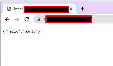

以下是我的測試程式 hello.py
  1. from sanic import Sanic
  2. from sanic.response import json
  3. from sanic.exceptions import NotFound
  4. app = Sanic(name="pyapp")
  5. @app.route('/')
  6. async def test(request):
  7.     return json({'hello': 'world'})
  8. if __name__ == '__main__':
  9.     app.error_handler.add(
  10.         NotFound,
  11.         lambda r, e: sanic.response.empty(status=404)
  12.     )
  13.     ssl = {
  14.     "cert": "/etc/letsencrypt/live/mytrading.coco-in.net/fullchain.pem",
  15.     "key": "/etc/letsencrypt/live/mytrading.coco-in.net/privkey.pem",
  16.     }
  17.     app.run(host='0.0.0.0', port=443, ssl=ssl)
複製代碼
可以成功的在外網開啟網址
