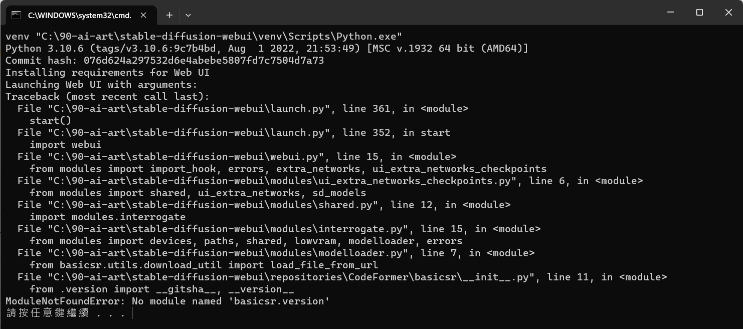

這是我後面遇到的問題
解決方法在這裡
https://www.reddit.com/r/StableD ... tomatic1111_stable/

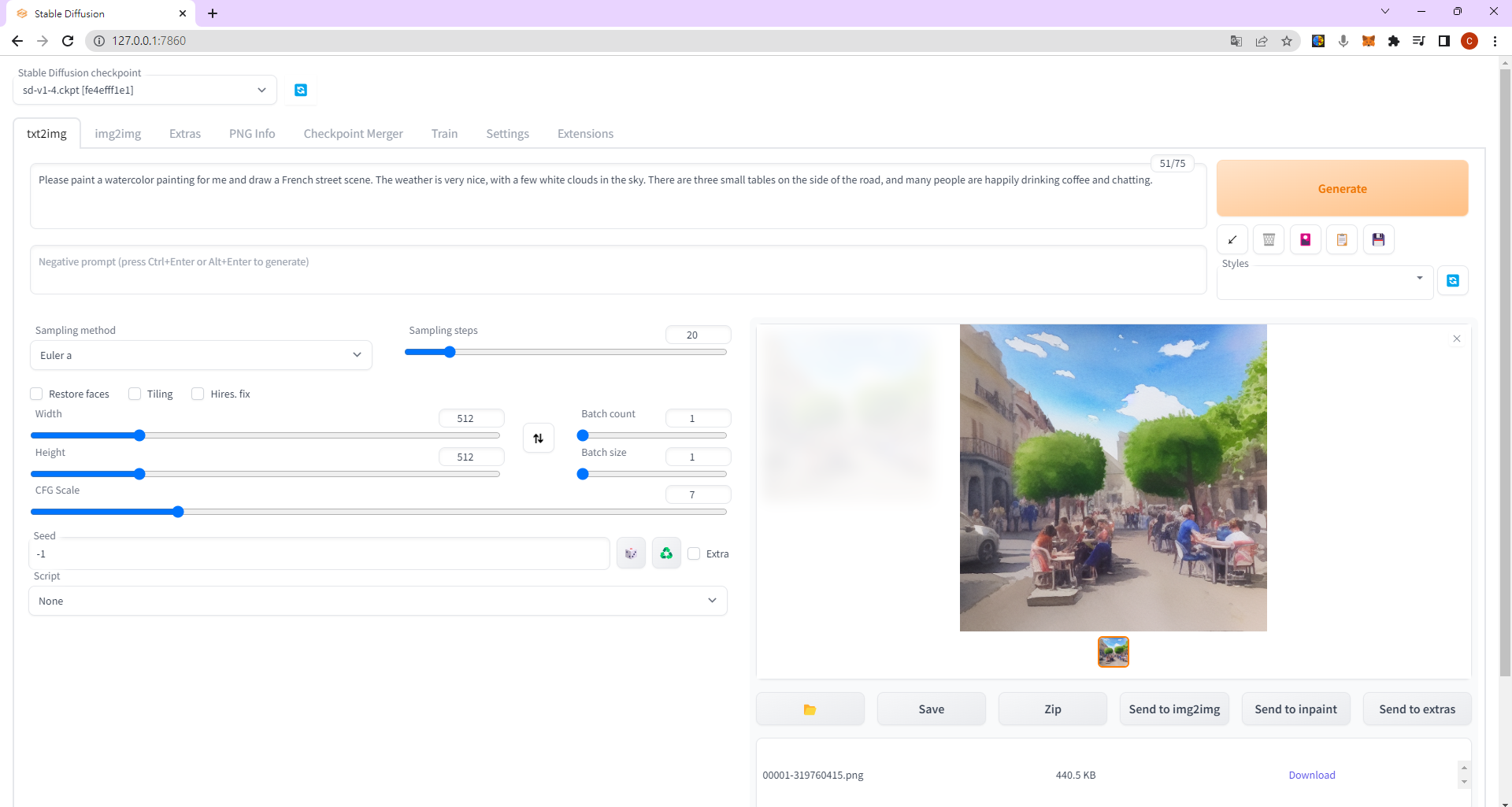

測試做出來的效果
  1. Please paint a watercolor painting for me and draw a French street scene. The weather is very nice, with a few white clouds in the sky. There are three small tables on the side of the road, and many people are happily drinking coffee and chatting.
複製代碼
執行畫面
