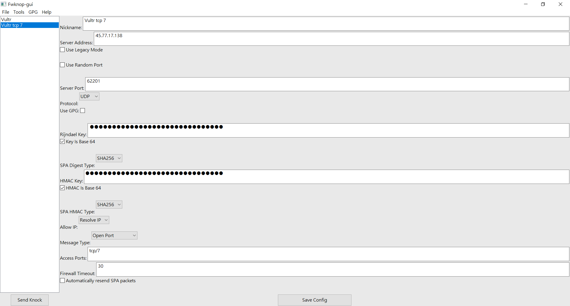

使用 Windows 版的 fwknop-gui.exe 來送 "密語" 至伺服器, 請它暫時(30秒)打開 Tcp Port 7 的通道 ... :
在 Fwknop-gui 的 "Rijndael Key" 欄, 應填入與伺服器同樣的 KEY_BASE64 值, 這台伺服器(ip : 45.77.17.138) 的 KEY_BASE64 值如下 :
  1. e4HchGSfm4DdfpI8LQsUPe/dVVeI0xZBDq6cpC8arO8=
複製代碼
在 Fwknop-gui 的 "HMAC Key" 欄, 應填入與伺服器同樣的 HMAC_KEY_BASE64 值, 這台伺服器(ip : 45.77.17.138) 的 HMAC_KEY_BASE64 值如下 :
  1. MK4MKf/em/E/ZtZ3cRFn5wFEM0NKCtODBhjzt9FOnmJOVEis3gluhKPlSCobtH9r/UnpqsD7vLN8kXueKcmvyA==
複製代碼
Windows 版 fwknop-gui by jp-bennett

沒有送打開孔洞的通關密語, 所以, 連接 Tcp Port 22 失敗 ... :
  1. root@debian:~# ssh 45.77.17.138
  2. ssh: connect to host 45.77.17.138 port 22: Connection timed out
複製代碼
送了打開孔洞的通關密語過去, 可以正常連接到 Tcp Port 22 ... :
  1. root@debian:~# fwknop -n my.server.com_tcp22 --verbose -R
  2. [+] Resolved external IP (via '/usr/bin/wget -U Fwknop/2.6.10 --secure-protocol=auto --quiet -O - https://www.cipherdyne.org/cgi-bin/myip') as: 112.105.240.229
  3. SPA Field Values:
  4. =================
  5.    Random Value: 4699983468226520
  6.        Username: root
  7.       Timestamp: 1600691688
  8.     FKO Version: 3.0.0
  9.    Message Type: 1 (Access msg)
  10. Message String: 112.105.240.229,tcp/22
  11.      Nat Access: <NULL>
  12.     Server Auth: <NULL>
  13. Client Timeout: 0
  14.     Digest Type: 3 (SHA256)
  15.       HMAC Type: 3 (SHA256)
  16. Encryption Type: 1 (Rijndael)
  17. Encryption Mode: 2 (CBC)
  18.    Encoded Data: 4699983468226520:cm9vdA:1600691688:3.0.0:1:MTEyLjEwNS4yNDAuMjI5LHRjcC8yMg
  19. SPA Data Digest: fMAweWrcz3BrxIQ7gz2Kxfq1RthpwWJgrDJco60m3sI
  20.            HMAC: 2uVqLu2+dHq7w7zIGueebYmrLq5nu7pUiwaZyW6MFck
  21. Final SPA Data: /7VtsmqmKFl6Nf1e3QuyjFucoWJF88419LlSOfnRXKHauKNVDkpHqBSCV4gEAYoqrpo6i9M38j5S9KqEdYqHjTsDotMIwUWPKOmPYAtBmhneH3+CfmkrlLCJmXma9MnUfCNF3jrZdGN89zZw+qYAmlm9+5INTIro49iyKfa8wWPabLWSTnr1Ld2uVqLu2+dHq7w7zIGueebYmrLq5nu7pUiwaZyW6MFck
  22. Generating SPA packet:
  23.             protocol: udp
  24.          source port: <OS assigned>
  25.     destination port: 62201
  26.              IP/host: 45.77.17.138
  27. send_spa_packet: bytes sent: 225
  28. root@debian:~# ssh 45.77.17.138
  29. The authenticity of host '45.77.17.138 (45.77.17.138)' can't be established.
  30. ECDSA key fingerprint is SHA256:8wtDpO6DT2WzDO5wdU9pHBJU3iOELf0Q/EXfnoZioJ8.
  31. Are you sure you want to continue connecting (yes/no)? yes
  32. Warning: Permanently added '45.77.17.138' (ECDSA) to the list of known hosts.
  33. root@45.77.17.138's password:
複製代碼
