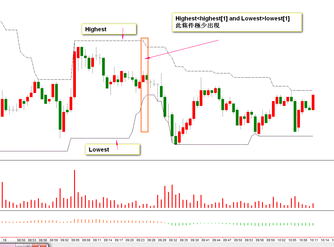

buy next  bar at market;
發表於 11-7-19 10:15 | 顯示全部樓層
Value2=Minlist(kbar,30);
value3= Highest(high,Value2);
value4= lowest(low,Value2);
if  marketposition = 0 and time>=0845 and time <=1315   then begin
問題在這一句
if     value3 < value3[1] and value4 > value4[1] then
