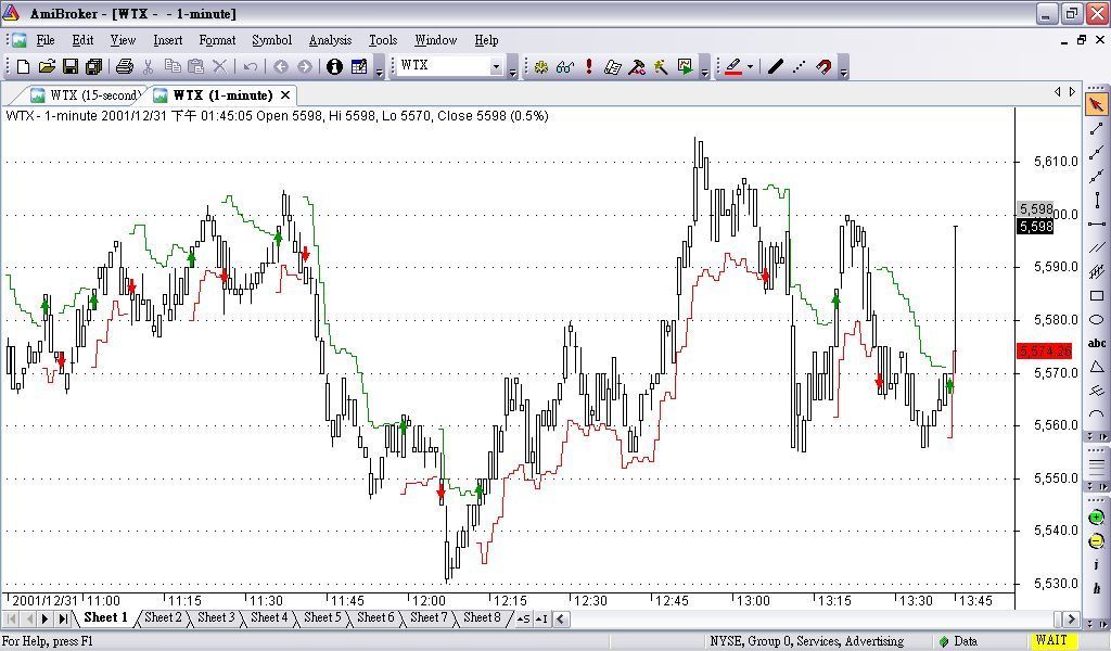

發表於 10-6-11 16:37 | 顯示全部樓層 |閱讀模式
  1. _SECTION_BEGIN("Ensign Volatility Stop");
  2. // Ensign Volatility Stop
  3. // get the multiple of 9 period EMA of ATR_Ensign
  4. k=Param("multiplication factor", 1,0.5,5,0.1);
  5. period=k*9;
  6. VS_raw = 2.5 * EMA(ATR(1), period);
  7. // for longs, VS line is below price
  8. loline = VS_below_price = HHV(Close, period) - VS_raw;
  9. // for shorts, VS line is above price
  10. hiline = VS_above_price = LLV(Close, period) + VS_raw;
  11. between = IIf (C < hiline AND C > loline, 1, 0);
  12. up = IIf(C > hiline OR (H > Ref(H, -1) AND H > hiline), 1, 0);
  13. dn = IIf(C < loline OR (L < Ref(L, -1) AND L < loline), 1, 0);
  14. upcond = IIf(between AND BarsSince(up) < BarsSince(dn) , 1, 0);
  15. dncond = IIf(between AND BarsSince(dn) < BarsSince(up) , 1, 0);
  16. upline = IIf(up OR upcond, loline, Null);
  17. dnline = IIf(dn OR dncond, hiline, Null);
  18. Plot(C, "", colorLightGrey, styleBar);
  19. Plot(upline, "", colorRed, styleStaircase) ;
  20. Plot(dnline, "", colorGreen, styleStaircase) ;
  21. Buy=upline;
  22. Sell=dnline;
  23. Buy=ExRem(Buy,Sell);
  24. Sell=ExRem(Sell,Buy);
  25. PlotShapes(Buy*shapeUpArrow,colorGreen);
  26. PlotShapes(Sell*shapeDownArrow,colorRed);
複製代碼

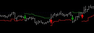

回復 1# alexwang7777
  1. PlotShapes(Buy*shapeUpArrow,colorRed);
  2. PlotShapes(Sell*shapeDownArrow,colorGreen);
複製代碼
