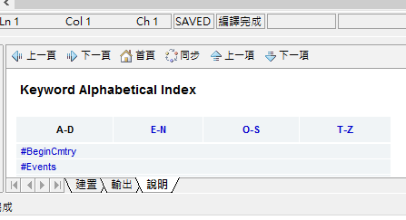

有個指令叫 print
你在編輯器下面能看到說明
或是去買本power language 的書來看
你的例子, 程式最下面加上所有會用的的變數
print(date," ",time," C:",close," M:",marketposition," ",buyflag," ",sellflag);
再去看有哪裡跟你想像中不一樣
