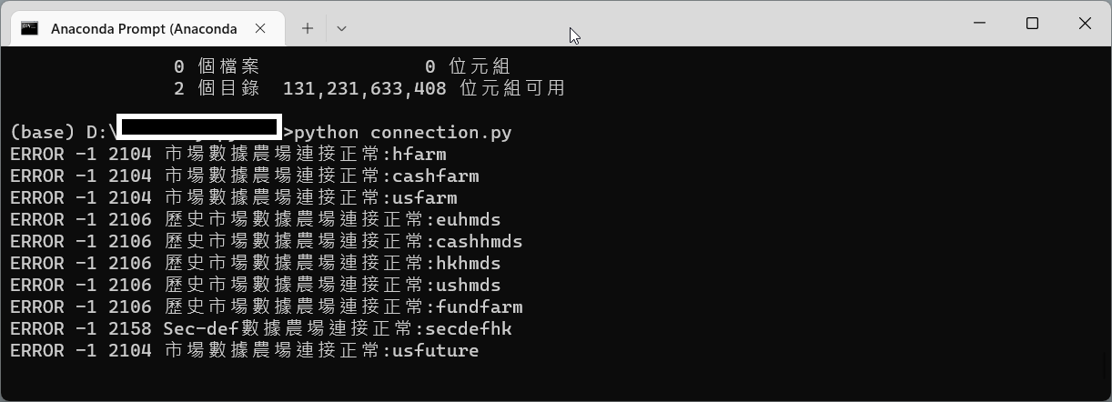

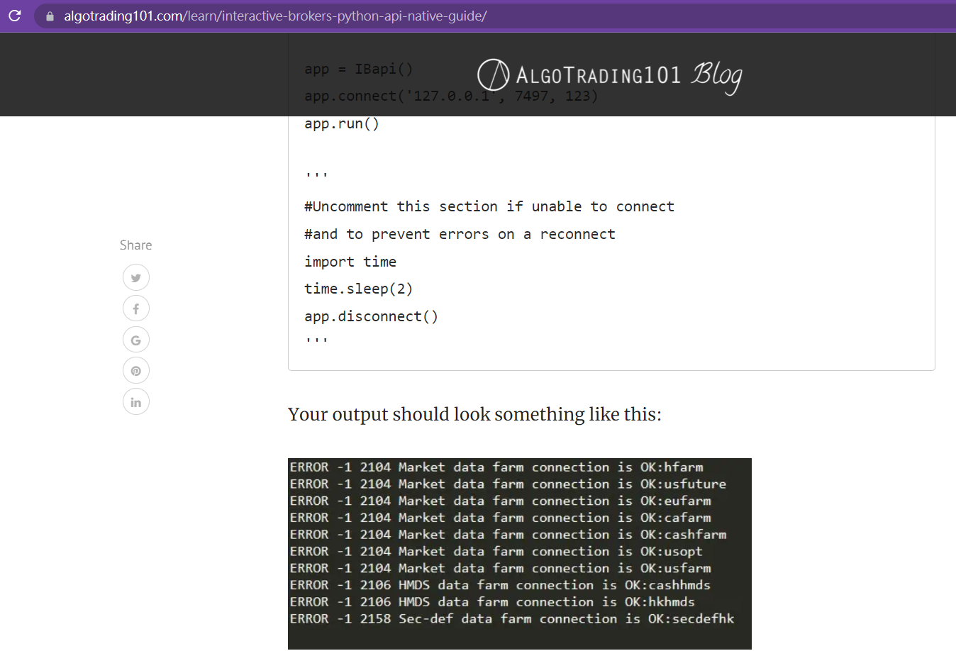

Interactive Brokers Python API (官方原生)
下面這一篇寫的很清楚。
我也不知道原生API有沒有比第三方API好用。反正就學學看
https://algotrading101.com/learn ... n-api-native-guide/
今天做到中間這裡 ,還滿好上手的。
我的測試
參與人數 1金錢 +3 收起 理由
tinyding + 3 感謝分享

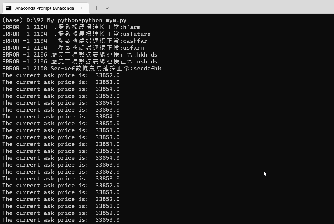

MYM取資料也OK了。(一樣是上面這篇教學)
程式碼如下:
  1. from ibapi.client import EClient
  2. from ibapi.wrapper import EWrapper
  3. from ibapi.contract import Contract
  4. import threading
  5. import time
  6. class IBapi(EWrapper, EClient):
  7.         def __init__(self):
  8.                 EClient.__init__(self, self)
  9.         def tickPrice(self, reqId, tickType, price, attrib):
  10.                 if tickType == 2 and reqId == 1:
  11.                         print('The current ask price is: ', price)
  12. def run_loop():
  13.         app.run()
  14. app = IBapi()
  15. app.connect('127.0.0.1', 7497, 123)
  16. #Start the socket in a thread
  17. api_thread = threading.Thread(target=run_loop, daemon=True)
  18. api_thread.start()
  19. time.sleep(1) #Sleep interval to allow time for connection to server
  20. #Create contract object
  21. contract = Contract()
  22. contract.symbol = "MYM"
  23. contract.secType = "FUT"
  24. contract.exchange = "CBOT"
  25. contract.currency = "USD"
  26. contract.lastTradeDateOrContractMonth = "202303"
  27. #Request Market Data
  28. app.reqMktData(1, contract, '', False, False, [])
  29. time.sleep(10) #Sleep interval to allow time for incoming price data
  30. app.disconnect()
複製代碼
